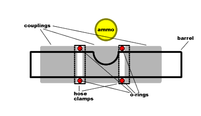

wat is the best way to make a breech barrel?
i dont want my whole barrel to move like the 1 in the 'how to's', how iv gone and done it is i cut a hole for the breech in my barrel but im wondering if i should just put a smaller peice of pvc with o rings at ither end and a small handle on the front end for the piece that seals and opens the breech.
how would you do it?
(this is for a pneumatic cannon)

Unread postAuthor: saladtossser » Sat Mar 18, 2006 12:30 pm
i know of a simpler way, one that does not need oring grooves, it wont leak if you do it right.
first frame
fast animation
slower
hope you get it

Unread postAuthor: )DEMON( » Sat Mar 18, 2006 12:49 pm
thanx il try it , it looks like it will work better than mine ,the grenade breech also looks simple but you have to cut grooves in your barrel, i dont want to have to use a new barrel again(i broke the last 1)
