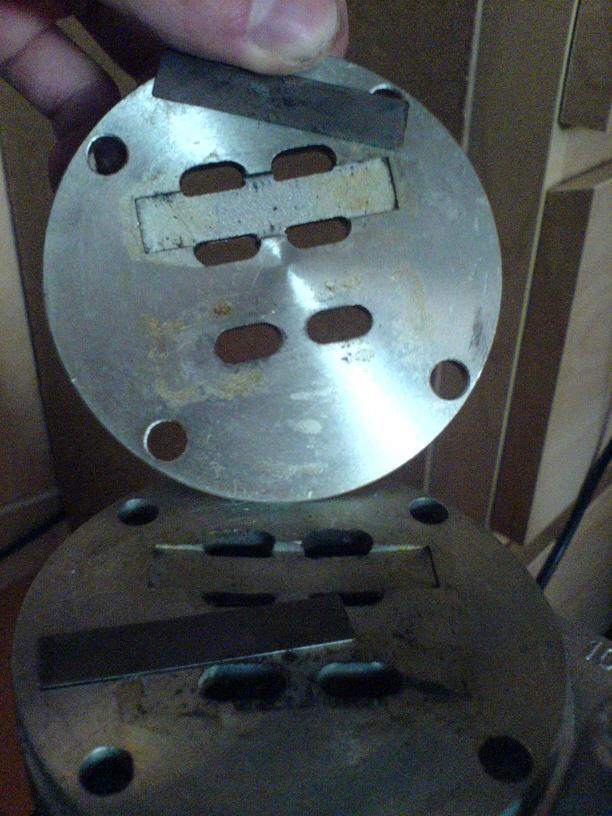

Here you can clearly see that the check valves are just metal strips.

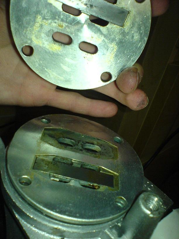

The check valves. Note that dead volume stops here, so the big empty cap doesnt matter.

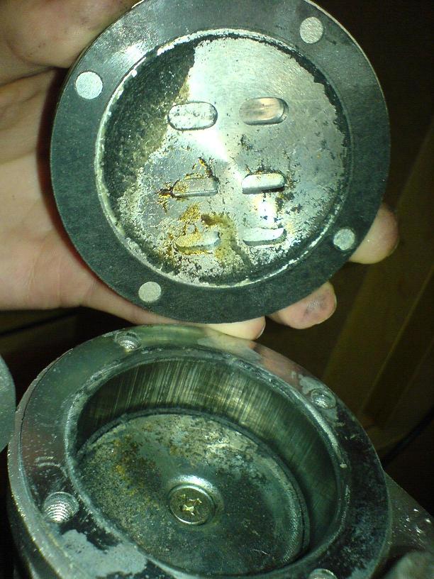

The cap is hollow on the inside.

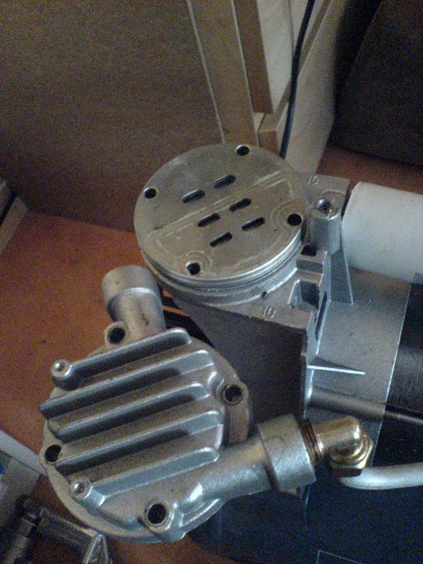

Opening it up.

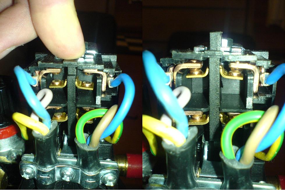

The switches that turn the power on and off. These get controlled by the spring, but when pressing in the red button to turn the compressor of (like I do with my finger here) they also open.

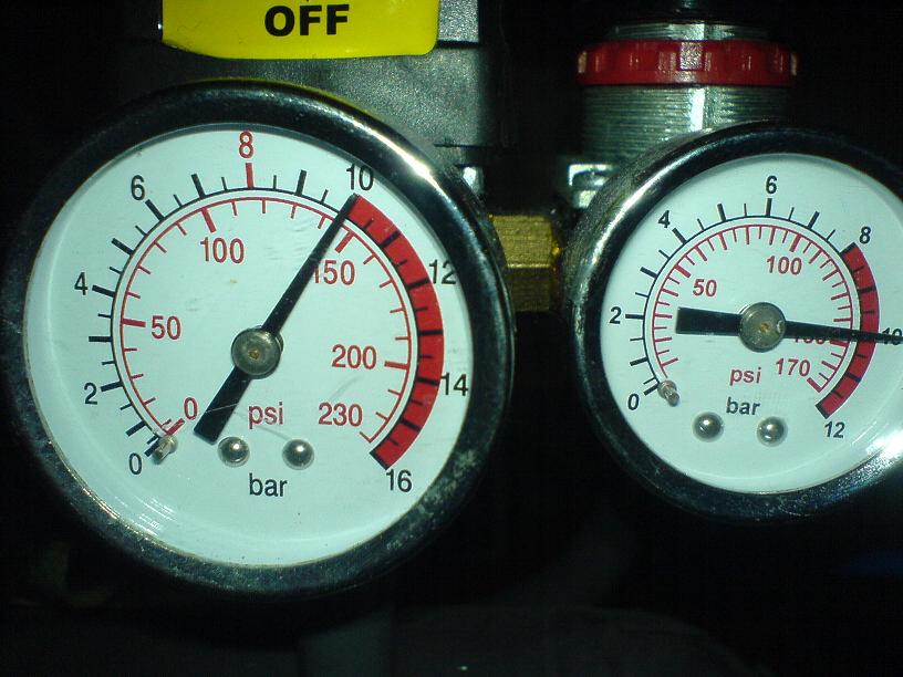

10 Bar! :D
