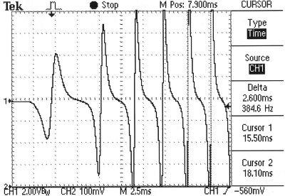

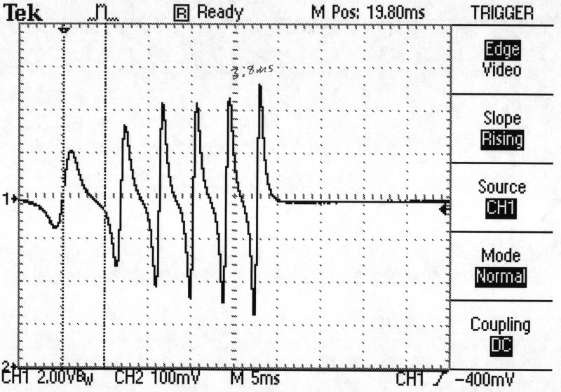

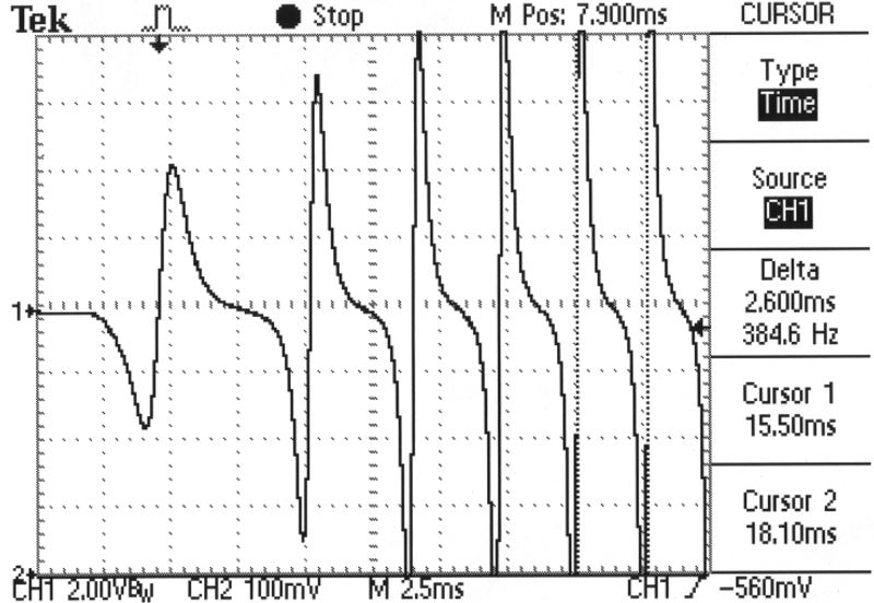

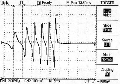

Unread postAuthor: Technician1002 » Wed Aug 05, 2009 4:28 pm
jackssmirkingrevenge wrote:
Gippeto wrote:Jack, do you REALLY think a dart is going to win this ??
I predict that the winning projectile will be more...old fashioned.
I'm actually rather taken aback that someone of your background doesn't agree. The fact that all the world's major armies rely on saboted darts as projectiles when penetration is the requirement should be proof enough of the benefits of high velocity resulting from low projectile weight as well as high sectional density.
It may be counter-intuitive, one would think that at the same velocity a 1" ball bearing will penetrate more than a 1/4" dart becaust it's heavier, but the fact is that per unit of projectile contact area, the dart has a lot more mass pushing it through the target medium.
Don't you remember the coin challenge? You don't need a lot of ft/lbs to push a dart-like projectile through a seemingly hard target, it's the reason why bowhunters can take down such large prey with relatively low muzzle energy behind their arrowheads.
Using a larger diameter saboted round is one way to get high energy into a round from lower pressure. The larger diameter round is why in the t shirt cannon, the larger diameter barrel won the testing of various barrel diameters on the 2 inch valve. More speed can be had when combined with a larger valve.
Part of the reason I'm building the 3 inch valve is to test golf ball speeds in a 2 inch, 2.5 inch, and 3 inch barrel. Not all my tests will be just venturi into a smaller barrel.
The time to travel the last foot of the barrel is marked in the photo below if you wish to calculate the FPS of this test. I'll leave the calculation as an exercise for the viewer. The answer is below 300 FPS. It is slower than the test results on the 3 inch barrel. The 3 inch and 2.5 inch did much better than the 2 inch.
  • 0
Acceleration data of a t shirt in the 4 inch barrel. T shirt cannon at 70 PSI with the 2 inch valve.
60 PSI 2.5 inch test shot. The measured foot is not the last foot of travel. Travel time is 2.6ms.The speed is considerably higher than the 4 inch barrel at less pressure. The 3 inch did even better.
Last edited by Technician1002 on Wed Aug 05, 2009 4:44 pm, edited 2 times in total.
