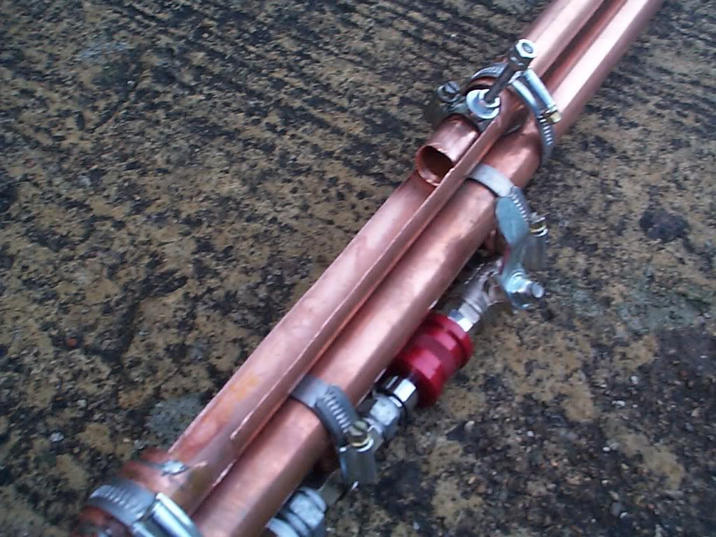

Unread postAuthor: Ragnarok » Wed Oct 14, 2009 11:14 am
A breech loader should seal as well as it can - and restrict flow as little as possible.
For your convenience, two early* pictures of what HEAL uses (Sorry, second photo is somewhat blurred):
http://i210.photobucket.com/albums/bb12 ... P01126.jpg
http://i210.photobucket.com/albums/bb12 ... P01127.jpg
*It has been redone more neatly since.
I designed this variant on the popular design for use at higher pressures, and to disrupt flow as little as possible - while keeping dead volume down.
The seal is a pipe into an appropriate fitting, complete with a thick grease - fine for the job, but I suppose it could be improved by cutting a slot into the walls of the "fitting" the pipe fits into so that it seals through an O-ring. Not entirely necessary though.
