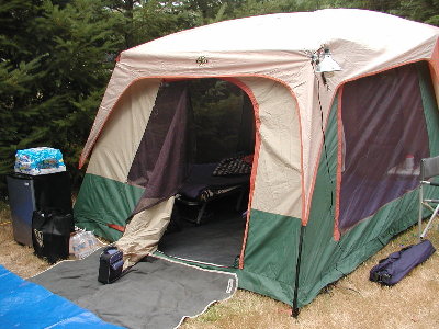

Unread postAuthor: Technician1002 » Wed Sep 15, 2010 10:08 am
Many problems people have with inverters is incorrect installation. I have one in my car and it runs my full size fridge. I used it durring an ice storm to keep the freezer frozen, a few lights, the TV (small one) and the computer running for the weekend.
Many people don't use Ohm's law to find the voltage drop on the low voltage side. When drawing 50-80 amps a hundredth of a ohm can cause low voltage to the inverter when a freezer tries to start and inverter shutdown. I'll post a photo later of an electrical panal I had to replace. While it was replaced, I used the inverter for lights, TV, and the Fridge.
On a normal car, they don't put out full current at idle, so don't load it to full power at idle. The battery will go flat. On a Prius, full power is avaliable at idle. :D
Instead of getting an oversize inverter, get one with surge capacity of 2X at least for starting motors. Then make sure the primary wire will keep the voltage at the inverter above 11.5 volts during the surge.
I use it with my compressor for field cannon use and I have used it with an electric chain saw to cut a tree down at the far end of my dad's hayfield. It was a little light for the chain saw. An extended heavy cut would trip it off.
My inverter. Note the small black power cord off to the left. It is ~24 inches long to the battery.
EDIT
Added photo of roughing it with the inverter. Electric lights, refrigerator, ran all weekend off a 25 foot extension to the Prius. The 42 watt CF is much brighter than a 2 mantel Coleman. The weekend took about 2 gallons of gas. We had ice cream in the freezer. :D
  • 0
Roughing it with no hook ups.
Last edited by Technician1002 on Wed Sep 15, 2010 12:44 pm, edited 1 time in total.
