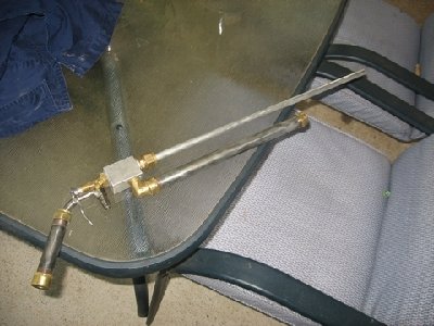

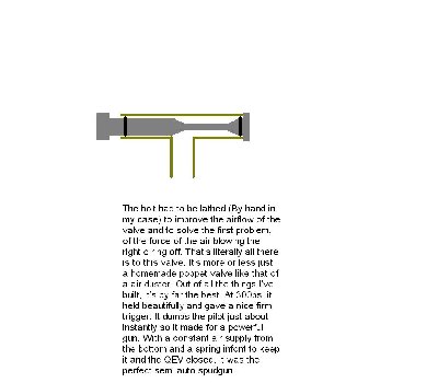

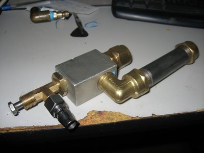

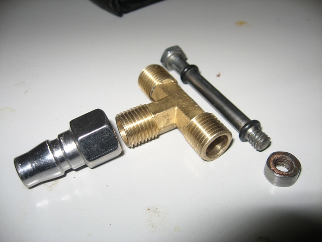

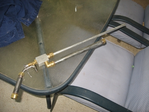

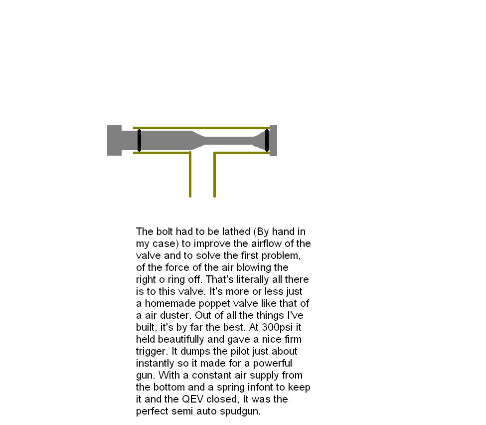

Unread postAuthor: Mitchza89 » Tue Nov 23, 2010 7:32 am
Here mate,
I hope this helps. This is the inner working of the parts of this valve.
Cheers!

Thank you VERY much !
It is exactly as I thought. But like I said in the P.M., it is good to see the inner workings in a cutaway view.
Also putting up the disassembled valve, was even better.
A one-two punch to making the valve understandable to a kindergarten audience, like me.
:D
Thank you.
I am hoping that between this and a homemade piston valve, I'll be able to build a couple small spudguns for friends, without having to buy sprinkler valves and blowguns.

It looks to me like the way your example gun works, is that you connect the air to the bottom of your poppet valve, add the air to the gun that way.
Then you have to pull the bolt in your poppet, back.
Then disconnect the air supply.
Then push the poppet bolt to dump the pilot volume.
Is that correct ?
ON EDIT: Ah. Never mind. Just read the text in the first pic. You use a spring to push the bolt closed. That would close the poppet as soon as you disconnected the air from the bottom.

Lol... sorry... but this doesn't make sense to me. It looks like, if there is a constant air supply, and the trigger is pushed, the air has no where to go? Do you disconnect the air after you fill it? Because you mentioned semi auto...
  • 0

Unread postAuthor: Gun Freak » Tue Nov 23, 2010 7:53 pm
Mitchza89 wrote:With a constant air supply from the bottom and a spring in front to keep it and the QEV closed, it was the perfect semi auto spudgun
It's from the diagram.
  • 0

Unread postAuthor: inonickname » Tue Nov 23, 2010 7:59 pm
Ah sorry, the picture didn't load when i went to look at it the first time. In that case I'm in the same boat. Not sure.

Unread postAuthor: Mitchza89 » Tue Nov 23, 2010 8:43 pm
As soon as you pressurize the gun, The pressure in front of the valve keeps it closed at all times automatically. It stays open but as soon as you disconnect the air supply, the pressure differential slams it closed. While the pressure is the same around the poppet valve and inside the gun is the same....you can close it just by effortlessly sliding it.
That's all there is to it mate :) I think I may have to bring this old gun back to life. I evolved from this hobby into homebrew. It started off just making beer from the tins that you get to your super market to a temperature controlled fridge, 4 kegs, a 10kg co2 setup and all the proper cooking equipment to make all-grain beer......beer the proper way and the way it's been done for thousands of years. Nothing more satisfying to have raw grain and make a crystal clear lager with a light creamy head and an amazing taste....for 30 bucks for 3 cartons :D:D

Unread postAuthor: Gun Freak » Tue Nov 23, 2010 9:36 pm
That still doesn't explain how you can get semi auto :roll:

Unread postAuthor: Mitchza89 » Tue Nov 23, 2010 11:13 pm
I had my air compressor hooked directly to the chamber. With constant pressure, the valve always stays closed. It's as simple as that :)
