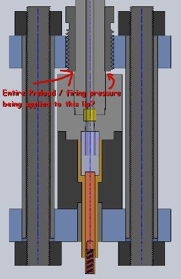

Unread postAuthor: Fnord » Thu Feb 09, 2012 7:04 pm
I'm not sure if I'm seeing this right, so correct me as needed.
Made an image since it's such a small detail to try and point out...
Are you going to be using a 'pressure differential/gas dielectric breakdown' trigger? This kinda looks a little like that thing I sketched up in your Al/H2O thread, but I don't think you ever commented on it so I assumed it was a crappy design :P
  • 0
Maybe you're within mechanical tolerances with this design, but if the pressure leaks into someplace it shouldn't be, it'll suddenly have a lot more surface area to push on.

Unread postAuthor: DYI » Sat Feb 11, 2012 10:04 pm
To answer a few questions which have popped up since I last checked this thread:
MC: I'll be using a bridgewire, when I get to the light gas experiments. I'm going to be building a kind of "medium pressure" test rig for this in the summer running a significantly lower starting pressure in a larger chamber before I get to the full version. Simply building the pump for the high pressure version will be a fairly involved task.
al-xg: Yes, the insulator is the gold coloured part. I am going to run a basic simulation, although due to the nature of the process involved (a transient pressure spike above the yield strength of most of the materials involved) the results will be less accurate than usual.
Fnord: As I mentioned above, arc initiation is via a bridgewire. I liked your idea, but it's way beyond the level I'm working at right now...
Your idea would be a very nice way to approach making one of these things semi-automatic, if one could come up with an insulator which survived the shots..
As regards the lip, what I'm counting on is that the only failure mechanism available is the barrel material squirting out the gap between the breech and the retaining section. I've seen that happen with polycarbonate before, but I'm not quite at the injection molding pressure for normalized 4340 yet :lol:
