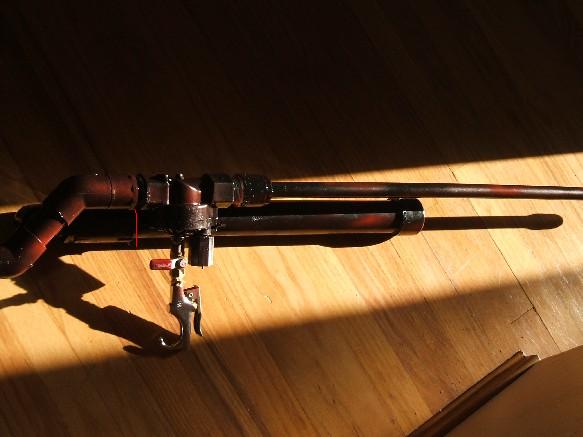

If you need plans for something, you shouldn't be building it. I designed <a href="http://www.spudfiles.com/forums/viewtopic.php?t=3607&"> mine</a> in 5 minutes, I could easily make it semi auto for 10 bucks.

I would only want to make mine semi auto if I was going to actually play at a paintball field with it because you wouldn't get 600 fps, just so you know. All you have to do is make a bolt action loading system like clide did on his semi auto gun and then cut down the chamber. On my rifle, I would cut it where the red line is in the pic. Then divide it into 2 different chambers, one about 1/6 the size of the other one. You can put a regulator, ball valve, or choke tubing in between the two chambers and you have a semiautomatic paintball gun (for 10 shots or so :lol: ).

I meant bolt action as when air comes through the firing valve, it pushes the "bolt" forwards, making it hit the ammo, then air comes through the "bolt" and pushes it out the rest of the way. Just think of the way any paintball gun works.
