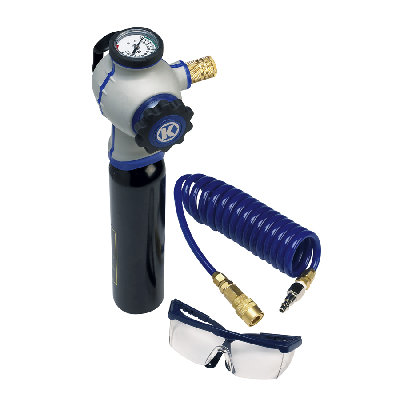

Unread postAuthor: Punstype » Thu Mar 22, 2007 10:00 pm
hey lukemc i was just at lowes and found this it costs about $100
you could hook this up and take your bbmg anywhere you go,and this
thing is refillable. its a co2 tank.i think it would be better to
use this to power your bbmg

Unread postAuthor: boilingleadbath » Fri Mar 23, 2007 6:21 am
I would expect the gasses to cool down fairly quickly... so it'd probably be best to forgo the stopcock, and just route the plasma conduit to the randomized pellet selector.
If we're lucky, we'll get a fair amount of mass throughput.
(translation: Just connect the chamber directly to the BBMG... with any luck, that'll give us enough time to to shoot a hundred or so BBs)
...and, yes, 3" sch 80 PVC will have no trouble containing the pressure... but so will cheaper stuff, like sch 40.

Unread postAuthor: CpTn_lAw » Fri Mar 23, 2007 7:54 am
do not use this kinda CO2 setup. I've used it once until the pressure gauge popped off in my stomach. 800psi of CO2 pushing it. I had a bad bruise for 2 weeks.

Unread postAuthor: singularity » Thu Jun 07, 2007 6:58 pm
don't buy it, its only got like a 9oz tank, for that same $100 you can have yourself a 5lb regulated co2 system. it will last a hundred times longer, for a new aluminum 5lb co2 tank its $60 and a regulator is $40
<a href="http://www.beveragefactory.com/index.shtml">this</a> is the place i bought mine from and i couldn't be happier with it. it lets you dominate the kids who have the $300 aegs
  • 0
