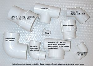

Identifying Pressure Rated PVC By Look
If you are having problems separating Pressure Rated PVC components from DWV PVC, these few differences should make it crystal clear next time you go to a hardware store.
DWV Fittings:
DWV PVC fittings have a few obvious traits that you can use to identify them.
Non Pressure Rated PVC Fittings (DWV)
  • Shallow sockets, DWV fittings have shorter socket depths in their fittings.
  • Ring around fitting, DWV fittings usually have a 'ring' around the outside of the sockets, Pressure Rated fittings, don't.
  • Thickness, DWV fittings and pipe are very thin compared to their Pressure Rated counterparts.
  • Odd shape, some DWV fittings look very odd and drastically different to Pressure Rated fittings.
Pressure Rated Fittings:
Pressure Rated PVC fittings generally have the opposite traits as DWV fittings.
  • Deeper socket lengths
  • 'Full' fitting, no rings around the fittings.
  • Thickness, thicker then DWV fittings.
  • Symmetrical look to the fitting, no odd shapes.
Common Misconception: Even though Bell Reducers look Pressure rated, in most cases they are not. It is best to stick to Reducing Bushings because they are usually pressure rated, make sure to check first though.
