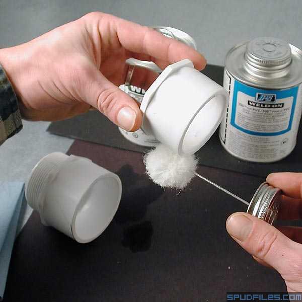

<div align="center">PVC SOLVENT WELDING
Provided By Latke - <a href="http://burntlatke.quibble.com">http://burntlatke.quibble.com</a>
<a href="http://burntlatke.quibble.com/weld.html"><img src="http://www.spudfiles.com/official_pics/weld-prime2.jpg" border="0"></a>
To see the rest please click on the picture.
Provided By Latke - <a href="http://burntlatke.quibble.com">http://burntlatke.quibble.com</a></div>

Solvent welding consists of priming the pipe/fitting and then applying the cement to both, inserting securely then 1/4 twist. The green PVC glue is just the cement. You can use any type of primer as far as I know. The stuff used in burntlake is clear stuff. If you intend to use clear PVC cement, check the label for pressure ratings just to be certain. For me, green is the pressure stuff.

You must always use primer, it a solvent that disolves the pvc so that the parts can be fused together as one piece. I recommend this: http://www.spudfiles.com/forums/solvent ... t3009.html

Ok cool, well i will look at that test when i have time, and can be bothered, so basicly the best thing to do is primer the two parts, then apply a fair it of PVC cement and push them togethor, and twist 1/4?
Posted: Wed May 16, 2007 3:50 am
by integral
In a nut shell...couldn't have said it better.
