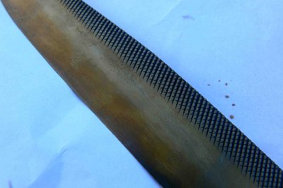

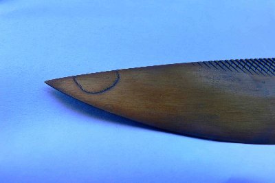

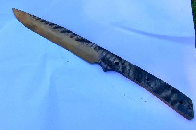

ok so i finally heat treated it today, did go as good as i had hoped, my dad was strongly saying that i didn't need to wear gloves, guess what, flames burnt my hands a little and it didn't go in as evenly as i wanted, the blade is a little bent but other then that i think it worked
heres a couple of pictures after its been hardened and the after being heated in the oven

What is that little blotch at the tip? Slag or a crack of some sort?
I'd suggest you try polishing and bluing the blade otherwise it'll rust quickly.
But overall it turned out pretty good so far.

looks like a crack, did you quench it in oil? did you try with a file that it is hardened? other than that it looks good :)

im not sure what that thing at the front is, there are some other smaller ones on there, i will try and sand them of but it will be hard

jakethebeast wrote:looks like a crack, did you quench it in oil?
i hope it isnt, yea i did
jakethebeast wrote:did you try with a file that it is hardened?
the darker part of the blade in the last photos is hard enough to not really be affected be the tip of a sharp scalpel, further back though still can be scratched
