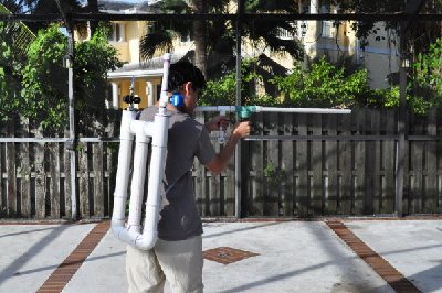

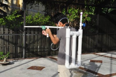

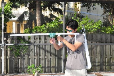

In each cannon, I try to add in 1 new feature. In this cannon, I added in an air regulator in order to get multiple shots. I have pressurized this to 80 psi.
Backpack: 3x 2" by 1.5' with fittings (~200 cubic inches)
Chamber: 3/4" by 2' with fittings (~11 cubic inches)
Barrel: 3/4" and 1/2" (~11 cubic inches and 5 cubic inches)
Straps: I use leftover tubing to create straps and no they are not pressurized)
Firing Valve: 3/4" Mod Sprinkler
The weird extension thing on the backpack contains my gauge and at the top is a schrader valve.
So far, I can get 3 40psi shots when the backpack is charged to 80psi.
Changes I need to make:
-Replace the tubing from the backpack to the chamber with a higher pressure-rated tubing (currently only 40psi). Planning to use some of those braided tubing.
-I'll probably make a larger chamber (double the size to ~20 cubic inches)

Nice @ clean cannon, i love the regulated backpack:D

Looks good. I like the backpack.
How do you let air flow from the backpack into the chamber?
Slow leaking? Manual valve?

Thank you. I'm planning to get some high rated tubing tomorrow so I can bring my chamber to 80 psi.
I got my regulator at Harbor Freight. It refilled itself to 40 psi in about 3 seconds.
I might make some nail darts but I haven't yet. I have an 8" metal rod (1/4" in diameter) and it has some tape at the end. I shot it at a plastic 3 ring binder (like the ones people use for school). I'll upload pics in a few days. I'm going to change my barrel to 1/2" and use AA batteries. Is there a way to make a magazine for AA batteries?
Thank you for all the feedback on the backpack :) I thought how annoyingly heavy a cannon with 2 chambers an a barrel would be.
