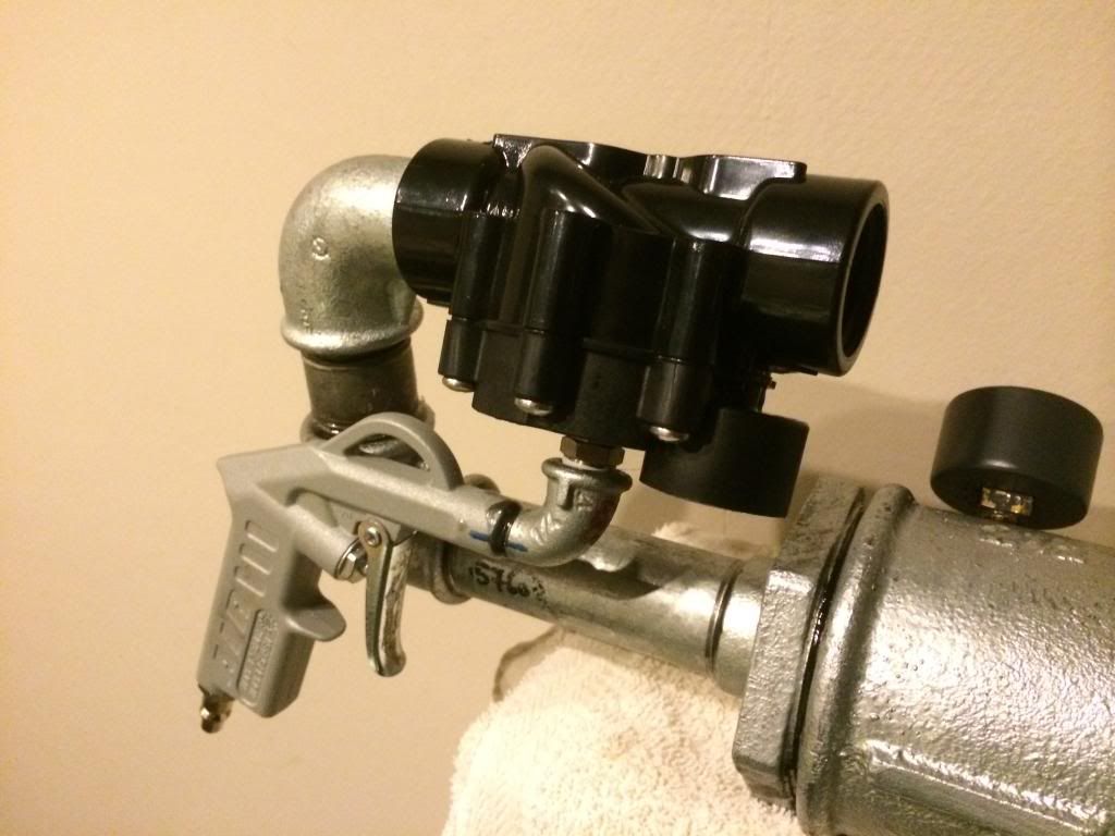

blowgun mounted on the valve
![Image](http://i44.photobucket.com/albums/f22/airpress/IMG_1593_zps4c6f59cd.jpg~original)
![Image](http://i44.photobucket.com/albums/f22/airpress/IMG_1592_zpseb0970fb.jpg~original)
![Image](http://i44.photobucket.com/albums/f22/airpress/IMG_1591_zps8b00e75f.jpg~original)

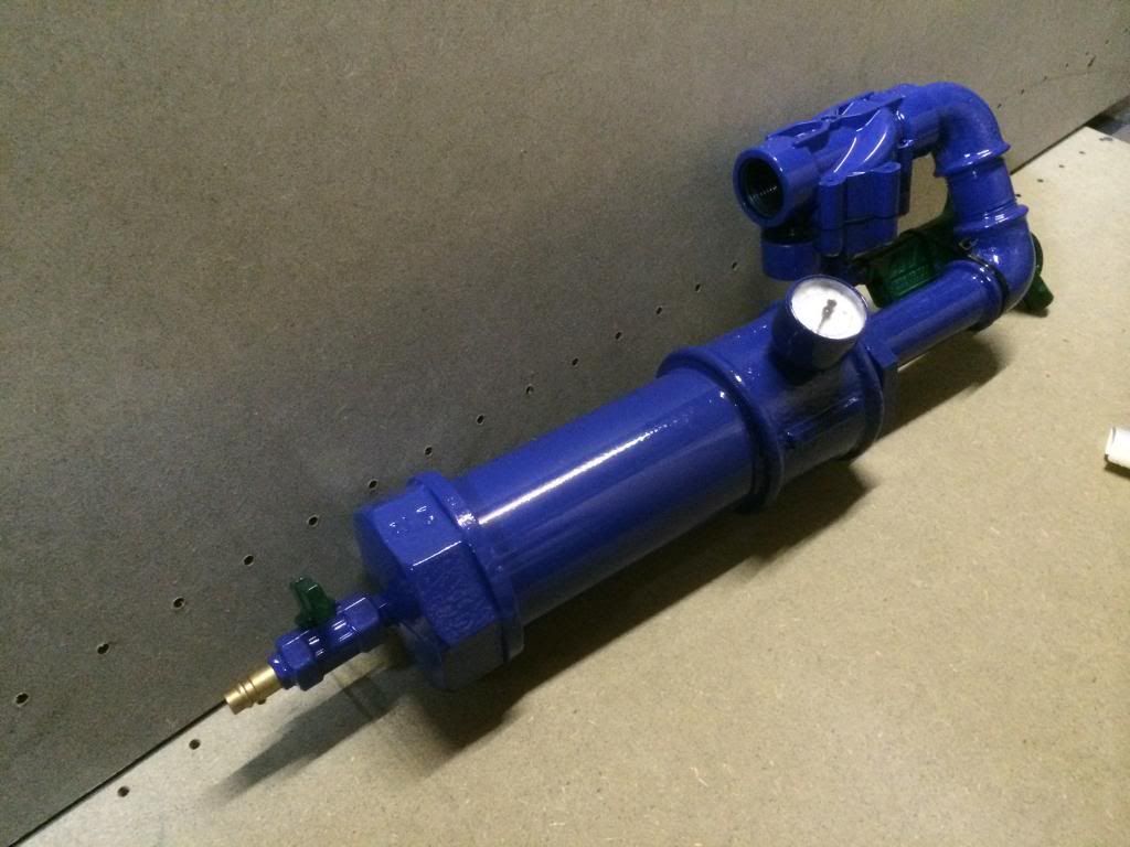

filling valve on the left side
![Image](http://i44.photobucket.com/albums/f22/airpress/IMG_1588_zps650597ed.jpg~original)
