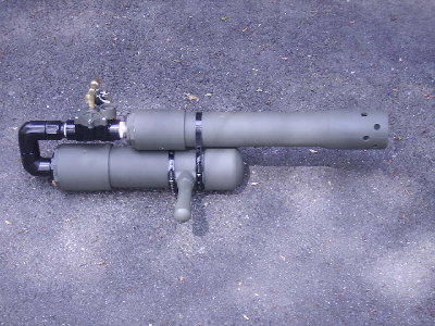

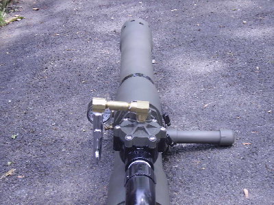

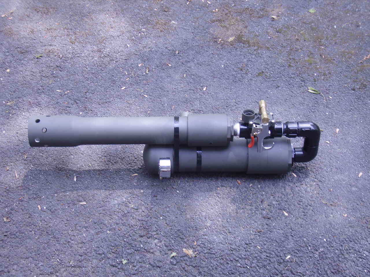

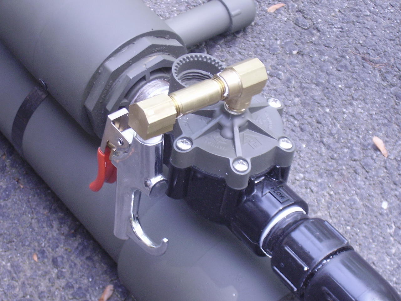

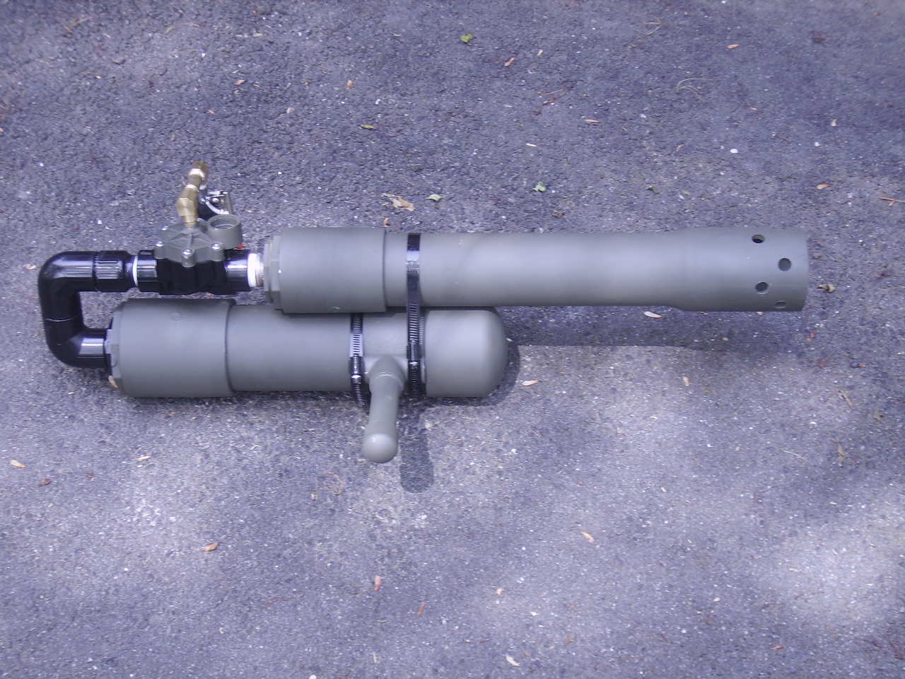

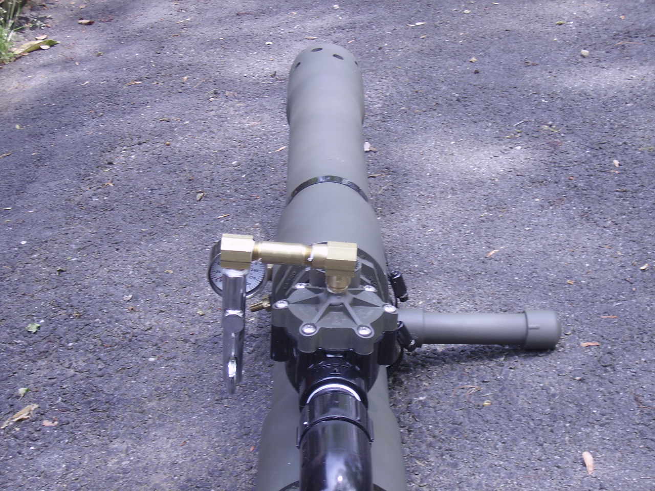

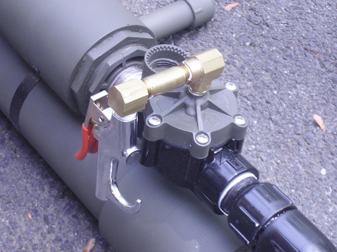

Well I finally crossed over to the dark side of pneumatic launchers. I have built a few combustions but didn't even know about air cannons until finding this site. I decided to make a tennis ball launcher in an over-under config. The chamber consists of 12" of 3" Pipe. The barrel is 18"s of 2.5" Sch40. Due to the barrel and chamber being so close I had to use a couple elbows and nipples to get the blowgun where I wanted it.
Valve and trigger
Valve and trigger
Rear View
Rear View
Left Side
Left Side
Right Side
Right Side

Nice i like it alot very clean

i wish i could build a tennis ball cannon :roll: but i don't think 2.5 inch pipe is avable in my area :( . nice gun thou, how far does that thing shoot?
Juicey
Posts: 46
Joined: Wed Apr 18, 2007 9:04 pm
Wed Apr 25, 2007 3:43 pm
Yeah I got lucky, I have a HUGE plumbing supply store right across from my house. So that makes this hobby rather convenient. I've only tested it up 40PSI so far. (Just finished it last night so I don't want to put to0 much strain on the new solvent welding) But in the test it fired between 50 and 70 yards. Was VERY quiet suprisingly. Im so use to combustion cannons leaving ringing in your ears, I was quite suprised by this one. Hope to get higher psi test fires tomorrow.

awesome canon, the blow gun is pretty cool its sturdier than a tubing, I can also see you shoot left handed

I like the use of the brass but just a suggestion ot help you...
Run a hose from the Sprinkler valve to the handle and attach the Bluwgun to the handle. It may things more one handed and less awkward. You will need a short peive of high pressure hose. Maybe that Plumbing Supply store.

I must agree very nice!Love that off set blow gun and were the handle is placed,I'm guessing its used like some type of LAW or RPG shooting style.
