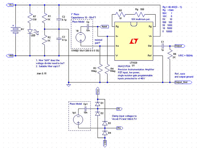

That isn't right.btrettel wrote: - The voltage across a piezoelectric element is proportional to the pressure differential, not the derivative of the pressure with respect to time. The wacky fluctuations seen in jimmy's circuit are likely due to a combination of sound, #2, and #3.
The voltage output of a piezo is proportional to the rate of change of the pressure (or the rate of change of the pressure differential).
A piezo sitting on the bench will read zero volts with a high Z DVM. Set a weight on the piezo and the reading will spike up, then down, then eventually dampen out to zero volts. Only a changing pressure causes a voltage output from the piezo.
I really don't see any reason for a separate detector at the muzzle. The extremely fast pressure drop when the round exits the barrel should be a very obvious signal. Of course, if you've got a spare data channel (like a stereo soundcard) then you might as well use it for something.
I've built a very high Z amp for Piezos as well. It isn't all that difficult. A FET instrumentation amp chip (not just a single FET OpAmp) works pretty well. I would recommend replacing the LF351 (which is just a FET OpAmp?) with a chip actually designed as an instrumentation amplifier. I used an INA121, which actually contains three OpAmps and some additional circuitry and costs about $7.
(The schematic shows an different OpAmp because my spice package doesn't include the INA121.) This amp was to boost the signal from a 1" piezo to record the sound of ants walking. The gain is set at 500 but for a pressure transducer you would probably want the gain at 1 or even less. Mostly what the amp is used for is to match the impedance of the piezo to the sound card's input.
You still have the problem of the capacitance of the piezo element making slow pressure changes disappear, especially since you also have to be able to get a useable signal when the rate of pressure change is very high (as in when the ammo exits the barrel). I'm not aware of any way to recreate data when all you've got to work with is 0V, 0V, 0V, 0V, 0V, 0V, 0V, 0V, 0V.
It sounds like you've got a pretty good handle on the problem. Be interesting to see what you can get.

A couple things;
1. You don't need a high gain amp. You actually will need to reduce the voltage the piezo generates since the sound card input is probably limited to about +/-1V swing. Smack the piezo with just your finger and you'll get several volts even on a DVM. In the combustion chamber it may well generate tens of volts or more when the pressure goes form 0 PSIG to ~60 PSIG in 20mS.
2. You need a high impedance amp. As Tech said the power of the crystal is very low. "High" voltage but almost zero current. If you actually draw any current from the piezo then it's voltage will sag.
That's why you use an FET based opamp. Very high input impedance of about 10^12 ohms. The problem is that at that input impedance things get wonky. In my circuit the input impedance is about 1Meg (set by the two bypass resitors on the input line), which should be high enough for the fairly robust signal that smacking the piezo this hard will produce.
My DVM has 10Meg input impedance. Piezos read 0mV. 10Meg of resitance isn't anywhere near enough resistance to read the static voltage. To measure that voltage you need a "charge amplifier" with an extremely high impedance. A Megaohm won't do it. A Gigaohm probably won't do it. Any resistor over a gigaohm or so is basically worthless since you are in the domain where the air is starting to conduct and shorting around the resistor.
The piezo generates significant voltage and current when it is smacked, just not enough to power a line or MIC input to a soundcard. I believe it is much easier to match that signals impedance to the soundcard input then integrate the signal then it is to just work with the piezos voltage directly and a very high impedance (>10^12ohm) amp. In the first case you are actually measuring the charge generated on the piezo and it is OK to remove that charge in the measuring process. In the second case you are trying to measure the voltage without actually removing any charge.
A piezo sparker generates ~10KV when the crystal is struck. If you set a heavy weight on the piezo it doesn't swing it's two faces up to a 10KV difference then just sit there. The crystal conducts and even without an external circuit the voltage difference goes back to zero once the pressure becomes static.

Since they have leakage current they generally require bias currents on their inputs. In most cases that current is tiny compared to the signal. To read the static voltage from a static piezo that bias current is going to be huge.Technician1002 wrote:Note the leakage currents the op amps have on the inputs. They are not zero current devices. For example you can't use one and measure a charge on a pocket comb by waving it near the input lead.
A plain old FET can easily read the charge on a pocket comb from a couple feet away. (For example http://www.eskimo.com/~billb/emotor/chargdet.html) Indeed, for many circuits an FET is considered to draw zero current. That is true when you are talking about normal current levels down to a couple microamps or even nanoamps. But even a nanoamp is a lot compared to what the piezo can source.

Since the value of a random piezo transducer is an unknown, a cut and try approach works fine. Try a 47 pf series with 100 pf in parallel for example if you want approximately a 4:1 divider.
Avoid large values, they load the circuit too much and will shunt it completely.
