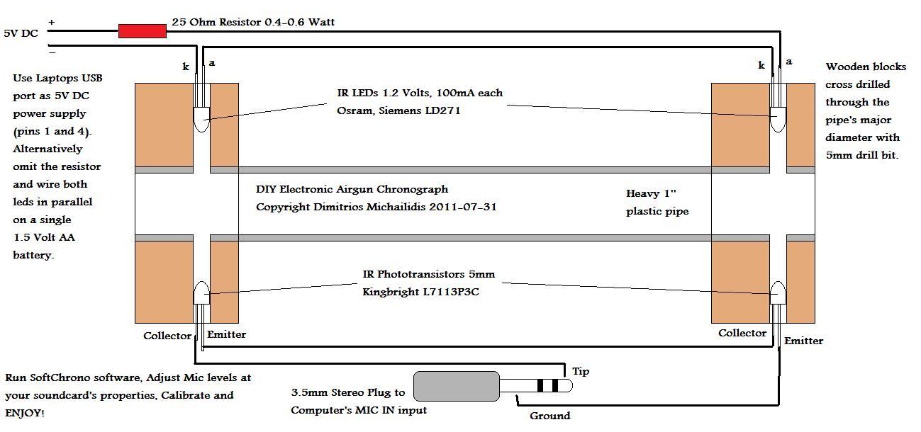

Re: simple diy ballistic chronograph
Posted: Sat Oct 08, 2016 11:52 am
by jimmy101
I think that is a bit more complex than needed. You don't need the IR LEDs since ambient light is usually enough. You can use a slice of a pipe to mount the phototransitors so that ambient light can get to the detectors. Since you don't need the LEDs you don't need to use the USB port.

If you are really cheap (raises hand) you can just use your phone (or laptop or tape recorder or ...) to record the sound of your gun firing at a piece of wood a measured distance from the barrel (watch out for the ricochet). The recording will have a strong signal when the ammo "uncorks" the barrel followed shortly thereafter by the sound of it hitting the target.

When I made mine I had all the parts lying around (including the Arduino). But starting from complete scratch would require an arduino (~$40), any laptop capable of running Arduino CC (which is any laptop made in the last 20 years capable of running debian: ~$50 - max not defined), and some IR LED's and phototransistors ($10).
Jimmy's method linked on his site is probably your best bet if you have a computer with a sound card (highly likely, includes integrated audio... sampling rates will obviously differ). Although, the software recommendations could be updated a little (*hint hint* :wink: , Audacity can do most of the things mentioned on the page at least on Debian).
If you're transitioning to Larda-level velocities, or you want something dead simple, you can build a break-wire chronograph, which is exactly what it sounds like (a wire carrying a sense current which when broken triggers either the "STOP" or "START" function of your "timer", which could also be a sound card).
