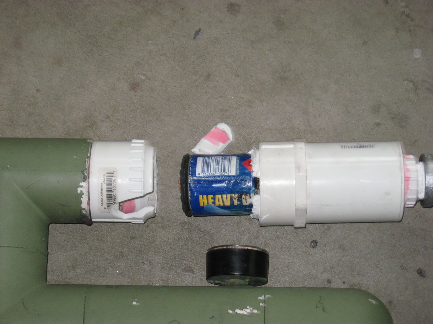

Well I was in the garage trying to rig up a new pilot setup for my SGA golfball cannon, which was leaking a bit.
So I finally found a good setup and just tinkered around trying to get it to work, I would worry about the huge pilot volume and uncomfortable triggering setup later, I just wanted it to work, leak and JB weld free.
I know what went wrong, the bumper on my piston wasn't enough to stop the piston flying into the back of the fitting, which tapers down on the inside to the threaded part of the fitting(threads on outside).
This happened at about 95psi by the way, blew my bloody ear drums out and a piece of PVC hit my check.

Yeah it is the gun in my sticky. My face is fine, i'm kinda happy, the power I got from this thing with the sprinkler valve on instead of ball valve was AMAZING!
I'll get it fixed soon enough, i'll have my restricted drivers licence soon so I can get fittings when I want.

As a matter of interest, is your bumper that section on the rear of the piston? And how much travel did it have to accelerate enough to do that kind of damage? A bit more that 0.375" methinks ;p

It's heavy duty foot spray, not mine, just found it in our house
The paint, is just your everyday camo green spray paint, we don't get kyrlon fusion here.
I've had part of this guns chamber blow up before, ever since then I hate using PVC at over 100psi, I wont be scared of pistons because I know exactly what went wrong and how to fix it.
With this setup it slams into a the tapered fitting, which I forgot all about, the piston travel would be about 2.5"
I know, I know, but like I said in my OP, I just wanted to get it to work, then I would start minimizing my massive pilot volume.
You don't want to even see what I have after that PVC threaded fitting, there is a 1" tee and a sprinkler valve with a 4" long nipple on it, It's all I had for the time being.

Yeah, that black part is the bumper, it's softer then it looks. And when I put this new pilot setup in I forgot that this bumper was probably only good for my old setup, where the piston(with bumper) slammed into four bolts.jackssmirkingrevenge wrote:ouch, glad you weren't seriously hurt.

You pilot volume was over 10 times larger than it should have been
Oh the humanity!
tsk tsk, you should have know better
I guess it's a cultural choice.
European perspective: make pilot volume as small as possible so it can be triggered with something with as little flow as a schrader.
American persepctive: make pilot volume as big as the chamber, who cares, then fit the biggest, baddest ass pilot valve you can afford.

By the way the 1/4 of the barrels diameter = piston travel only applies to co-axials according to clide, he said give it a bit more in barrel sealers.
With my old setup is was just over an inch, but this was merely a temporary test setup, trust me I would've minimised dead space as much as possible before presenting it to you JSR
