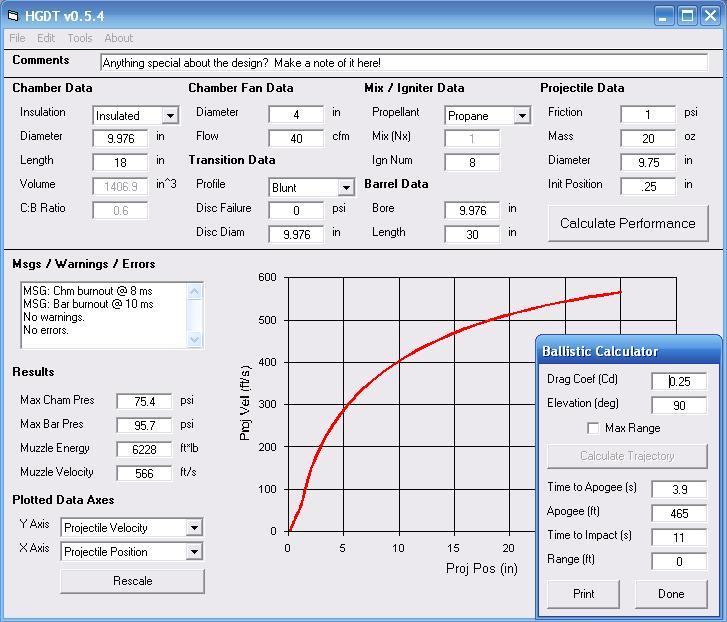

Maybe you should also add to the equasion how many shots will you get out of each basketball and how many are you willing to buy?

Good point. I wonder how many shots a basketball could take out of a cannon like this?
If I were to build build this, I'd also have to figure out a way to plug one end of it. Since a 10" cap costs several hundred dollars, I'd probably use concrete to cast a base around the pipe, which would make the cannon even harder to transport.

You could build a plug out of wood and seal it with silocone/epoxy/simular and screws to help hold it in.

10" SCH40....
A quick calculation, comparing 1" sch40 to 10" sch40.
According to wikipedia:
1" SCH40
OD: 33.40 mm
Wall thickness: 3.378 mm
ID: 33.40-(2*3.378) = 26.6 mm
ID:wall ratio: 7.87
10" SCH40
OD: 273.05 mm
Wall: 9.271 mm
ID: 273.05-(2*9.271) = 254 mm
Ratio: 27.4
So the burst pressure of 10" sch40 is...
27.4/7.87=3.84
Almost 4 times LOWER than 1" sch40!
1" sch40 can be used up to, what...? 150 psi?
Then 150/4=37.5 psi
You can use this 10" pipe only up to ~40 psi.
You NEED SCH80 for a simple combustion.
EDIT:
Or metal pipe.
