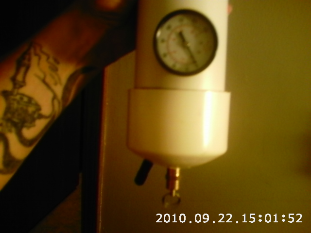

here is a few picks of the chamber and valve assembly. i didn't include the barrel cause i made it interchangeable, all my PVC pipes are pressure rated.
My downfall is the end cap, coupling's and other attachments i had to buy didn't say if they where pressure rated or not.

With that way you drilled into a single layer or pvc three times, I would only trust this launcher up to 100 psi. Some people may suggest even lower How high have you been using it?

The only problem I see is that you tapped the gauge into a single layer of pipe. If not for that I would say 80 PSI, but since you did personally I would rebuild it but at 30 you MAY be safe. Other than that nice, clean first pneumatic.
Edit-Gen Freak beat me to it but trust me, 100 PSI is not a good idea

@ tech, i had to order the 1" valve off the internet cause i couldn't find them in any stores around me. i tried Lowes, home depot and a few others. as for the gauge i had wondered if re doing the chamber so the gauge goes through the end cap and inner PVC would be better but wasn't sure. so far Ive had it up-to 60psi using a bike pump, didn't hear no leaks or anything, all i noticed is how hard it got to pump at that point. if i make the chamber shorter when i re-build it will that affect the amount of pressure i can use?
No, shortening the chamber will not affect the level of pressure the pipe can take. It will affect performance though.
