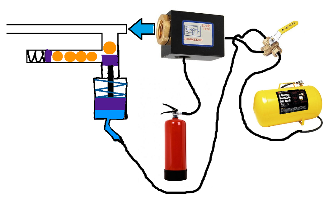

So this is now it's own thread... better put some more info
I'm trying to make a mag design like this:
The air hose at the bottom connects to my QEV air chamber.
The springs I have ordered:
For the mag:
1.75 " long, .218" OD, .6" compressed length, with .69 lbs at max. They are 12 to a package.
For the piston: .
813" long, .36" OD, .267" compressed length, 7.41 lbs at max. They are 5 to a package.
I planned my piston (that loads the bb) to be 1/4" thick, with a 'scoop' in it so it makes the bottom of the place where the bb is loaded round, to match the barrel that I will cut out.
The other piston is more flexible in thickness, but most likely will also be 1/4"
There is context to how I came up with my measurements. (I will have updated diagrams soon)
If anyone sees a design flaw, or an impossibility/improbability please mention it. (Use the 3d model and designs already here---scroll a little bit up) The point of how the red tube connects to the blue (ref, 3d model) has already been brought up.
Here's a picture of the mag charging with the QEV. The trigger has not been pulled yet.
Also please note that I didn't really make this thread, it's a side conversation that got moved from the machinists thread.
For the mag:
For the piston: .

How does air go past the loading piston?
Why such a tiny magazine?
What keeps the BBs from shooting out?

It doesn't. The right end of the barrel attaches to the QEV, it's only closed because I was lazy.. The loading piston is attached to the QEV air chamber/exhast port.JSR wrote:How does air go past the loading piston?
In my drawings it's 7". It will hold a lot more bb's xD (mebbe approx 24).JSR wrote:Why such a tiny magazine?
?JSR wrote:What keeps the BBs from shooting out?
The air from the loading piston should not escape past the loading piston.
When the trigger is pulled, air goes from the QEV air chamber out the barrel, letting the spring push the piston down and loading another bb.

Ah, right. Like the attached.PaperNinja wrote:It doesn't. The right end of the barrel attaches to the QEV, it's only closed because I was lazy.. The loading piston is attached to the QEV air chamber/exhast port.
If your spring is only 1.75" long though...In my drawings it's 7". It will hold a lot more bb's xD (mebbe approx 24).
There is a possibility that the mag spring will push the BBs out on its own...The air from the loading piston should not escape past the loading piston.

You need to make the loading piston longer, if it pushes the bb all the way up to the barrel the bbs in the magazine will be pushed under the loading piston.
