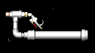

hi guys i just wanted some thoughts on whether you guys like this design or if you see any down falls.

The way you drew it, pulling the trigger on the blowgun will just empty the chamber through the blowgun - you need to reverse and and trigger connections on the QEV.
Do you want this single shot or multi-shot from a single fill?

If you open the breech with your left hand and insert the projectile in the barrel with your right hand, whats holding the gun?
You also want to limit the bolt travel. In your design, if you let go of the bolt in the unlocked position, the barrel will fall out.

Good design buddy, it looks pretty complex do you think you can do it ?
It looks very similar to the one in H.M Buckley Air pneumatics have a look there and see what you can find just search on youtube and you can see people who has created airguns from that book

yeah im pretty confident i have made a airgun before but it just looks way to ghetto for my liking im pretty good and using machinery thanks to my dad allowing me to play with dangerous tools from a young age so i think i can get it done im gonna hope fully start the machining tomorrow so ill take lots of pics and keep you all upto date throughout my build.
rite just got to my workshop to find that my brother has tidied my work shop and has thrown out my billet of steel and hidden my cutters for my mill fml so i have ordered some aluminum instead a lot easier to cut and should be able to update you all by thursday next week as that's my next day of from work i hate my life working is so unfair.

That's pretty cool man ... How r u gonna bore out the block and how much did you pay for the stainless steel barrel and where did you get .... What's the calibre your aiming for or what size do you want ?
