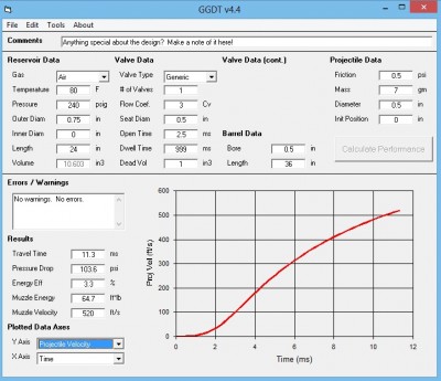

Download GGDT to simulate the performance of your launcher: http://www.thehalls-in-bfe.com/GGDT/

Here's a rough simulation with a 2 foot 3/4" chamber and 3 foot 1/2" barrel, firing a half inch steel ball bearing at 240 psi.
You're at over 60 ft-lbs, more than 5 times the 12 ft-lbs legal limit for an unlicensed air rifle in the UK...
