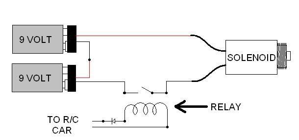

if you are using the same model car as i am then you will notice as soon as you turn on the car it should start moving backwards in circles, if we do not fix this as soon as we turn on the "detonator" the device will fire becuase any voltage forward or reverse can activate the relay. this is why we need the diode (diodes only allow current to flow in one direction) but before we solder the diode we are going to need to know which of the motor leads to solder it to. this is very simple to determine... turn on the r/c car do not touch the remote and use the multi meter to measure the voltage coming out of the wires which used to connect to the motor. if there is a minus sign on the screen switch the multi meter leads until it disappears then solder the diode (backwards) to the positive lead then turn the car off (when the multi meter is reading a positive voltage it would be the wire the red lead is touching) while you were reading the voltage of the motor you should have noticed something it was only 3v this will not activate our 5v relay (for obvious reasons) this is also very easy to fix. if you look at the battery box you should see there are three sets of wires connected to it (instead of the usual two)what you need to do here is find the positive 3v wire and connect it to the positive 5v lead on the box (again you need to use the multimeter but you do not need the car to be on) after this is done there should only be two sets of wires connected to the battery box. | if you are using the same model car as i am then you will notice as soon as you turn on the car it should start moving backwards in circles, if we do not fix this as soon as we turn on the "detonator" the device will fire becuase any voltage forward or reverse can activate the relay. this is why we need the diode (diodes only allow current to flow in one direction) but before we solder the diode we are going to need to know which of the motor leads to solder it to. this is very simple to determine... turn on the r/c car do not touch the remote and use the multi meter to measure the voltage coming out of the wires which used to connect to the motor. if there is a minus sign on the screen switch the multi meter leads until it disappears then solder the diode (backwards) to the positive lead then turn the car off (when the multi meter is reading a positive voltage it would be the wire the red lead is touching) while you were reading the voltage of the motor you should have noticed something it was only 3v this will not activate our 5v relay (for obvious reasons) this is also very easy to fix. if you look at the battery box you should see there are three sets of wires connected to it (instead of the usual two)what you need to do here is find the positive 3v wire and connect it to the positive 5v lead on the box (again you need to use the multimeter but you do not need the car to be on) after this is done there should only be two sets of wires connected to the battery box. | ||

most of the hard stuff (if you would even consider it that) is done now all we need to do is connect the relay and 9v batterys. first solder the wires that used to connect to the motor to the coil side of the relay. next solder the 9v battery leads in series then connect one of the wires to the switch side of the relay and the other to the solenoid. lastly connect the remaining solenoid wire to the remaining switch lead on the relay.and thats pretty much it just connect up an antenna and your done. heres a basic diagram of what you should have when your done | most of the hard stuff (if you would even consider it that) is done now all we need to do is connect the relay and 9v batterys. first solder the wires that used to connect to the motor to the coil side of the relay. next solder the 9v battery leads in series then connect one of the wires to the switch side of the relay and the other to the solenoid. lastly connect the remaining solenoid wire to the remaining switch lead on the relay.and thats pretty much it just connect up an antenna and your done. heres a basic diagram of what you should have when your done | ||

...part three : wiring....
<img src="http://i78.photobucket.com/albums/j85/irwinner_2006/rcdetonatorcircuit.jpg">
