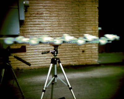

Using a muzzle brake, compensator, silencer, suppressor, or anything to reduce muzzle blast does affect accuracy. Even chamber size to barrel size so the blast is reduced make a difference.
Attached is an early composite photo of a high speed t shirt launch where muzzle blast and a corner of the t shirt being loose cause a very early tumble.
Fixing our muzzle blast with a muzzle brake and modifying our shirt roll improved the range and accuracy.
T Shirt tumble in 5 feet
