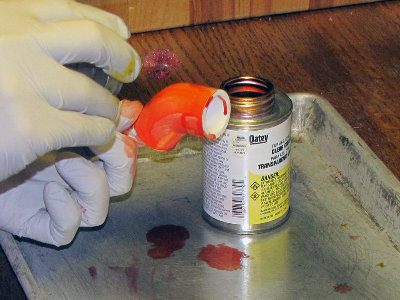

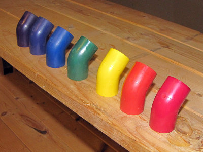

Edit, could not get linked photos to work. Adding them below.
You can make batches of many colors
Staining PVC with a custom color other than purple.

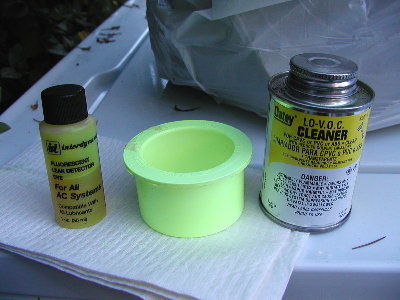

I had to try this. I stopped by my local hardware store and found the right cleaner. :D I have some oil dye that is used to find leaks in refrigeration systems by making the oil glow under blacklight. The photos show the result. Success. :D My camera doesn't like the fluorescent color and shows it much more green than it is. It looks more like a yellow fluorescent highlighter. It is bright. I may grab a photo with it under blacklight later.
As in the original linked article, a little dye goes a long way. Use it like you would use food color.

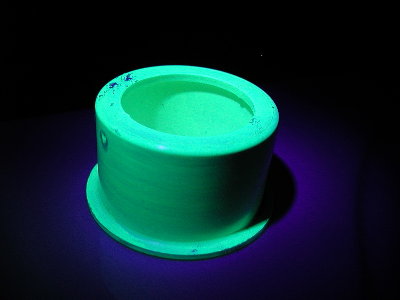

Edit; Added blacklight shot.

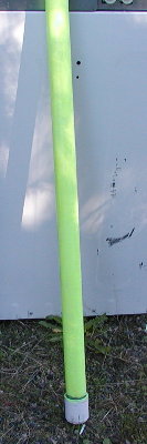

The barrel is bright yellow green.  This is the golfball barrel for my Marshmallow Cannon.
The ingredients are Cleaner and oil based dye
It is very bright in Blacklight.  I may do something creative for Halloween.  This is still sitting on the white sink.

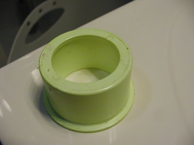

Normal white light photo.  This photo looks very close to it's real color.
