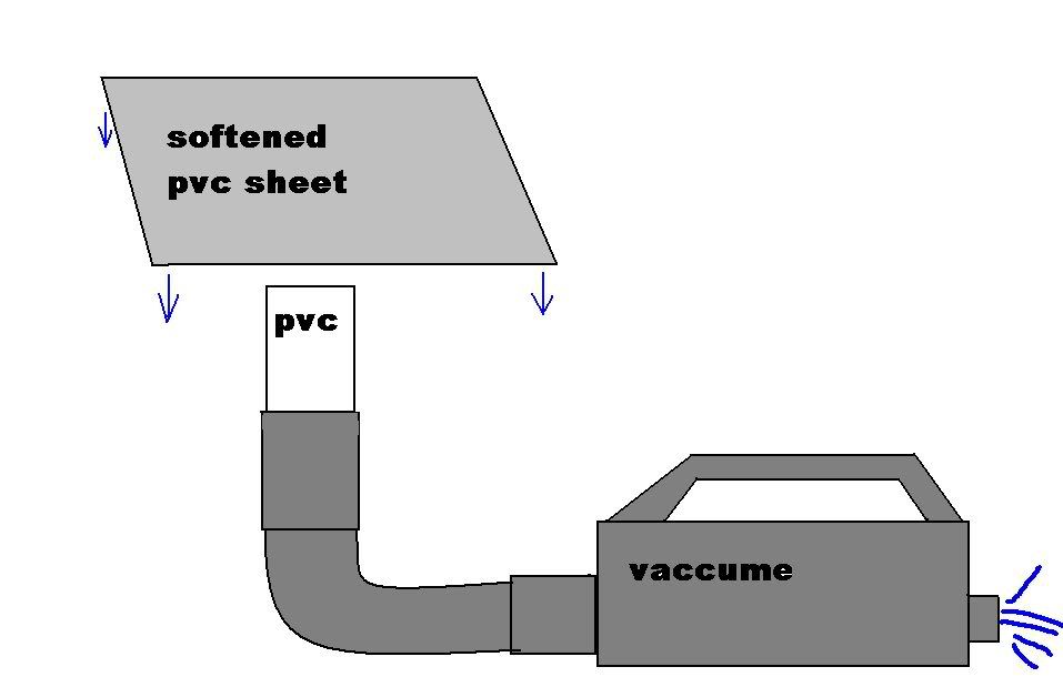

Ok well i'm pretty new to spud guns and i just came up with this idea im not sure if any one has already thought of this so if some one already has dont lose it.
I was watching mythbustes and i saw the girl making model frames for a rc car with this machine that used heated plastic and a vaccume device to mold stuff perfectly. So i thought to myself what a perfect way to make shells for a potato gun
<a href="http://s251.photobucket.com/albums/gg31 ... shells.jpg" target="_blank"><img src="http://i251.photobucket.com/albums/gg31 ... shells.jpg" border="0" alt="Photobucket"></a>
i might be a little confusing so pm me if you want further details

I think it will be hard to get the vaccume powerful enough and the pvc soft enough. but i think it could work though.

For some reason, this sounds a lot more complicated and prone to failure than casting wax, ice, Pykrete, concrete, aluminum, or lead, and then simply drilling out an appropriately sized hole in the back for stability.

It is good that you are thinking, but it would be a lot easier just to use a section of pipe the same size as the barrel.

yea now i realize that it would be hard but if one of you out there has the skills i was just putting the idea out

actually, i think this would work fairly well........
vaccum-formed things are EXTREMELY consistent. i think i might actually try this....

this is a very good idea it may be harder to do than some alternatives but just being able to actually create one would make it all worthwhile.

Bear in mind that a vacuum only creates (at an unlikely best) a 15psi difference across the sheet so material would need to be pretty soft or thin.
Blow moulding is the opposite and can use much higher forces (if you needed them).

Hotwired wrote: Blow moulding is the opposite and can use much higher forces (if you needed them).
do you mean like using compressed air and shooting it at the pvc sheet resulting in the pvc sheet being pushed in the pipe?
if so you could use both at the same time to make it a more even mold(so there are less thin spots)

Wouldn't need to have both.
If you use a vacuum it's practically identical to using compressed gas at up to 15psig on the other side. So might as well just use one but have it as strong as it needs to be.

yea your probably right
