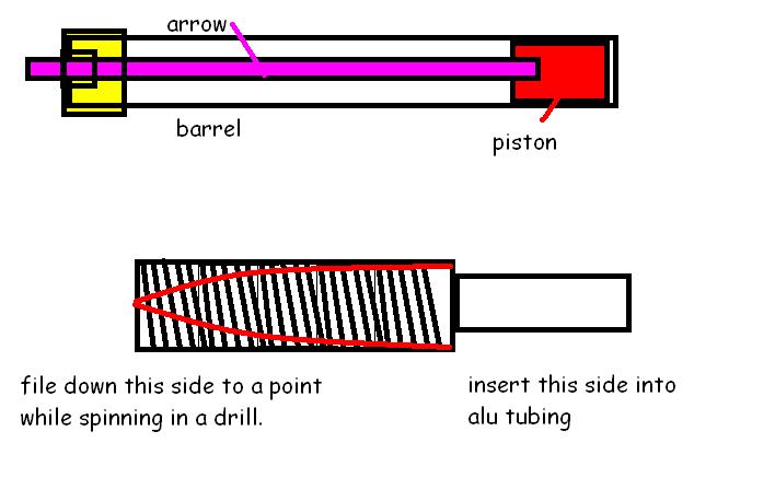

With a regular qev or piston gun, iamgine you put a piston ( like a permanent sabot) in the barrel.On the muzzle you put a reducer, to go down to the size the arrow will go through.The piston should have a hole in it drilled about halfway from the front, to accept the arrow.
You now have a silent airrow gun.
You will need to vent the barrel to reset the piston, or make it slightly leaky.
Arrows are best made from aluminium tubing ( 8mm) and a bolt as the tip.
You take an oversized bolt, put it in a drill and grind it down to fit the tubing.The tip itself should remain bigger.
Now put the grinded down end in the drill and spin the other side to a point.
To insert sideblades ( ??) put a slit in the bolt lengthwise before you "lathe"it. After the arrowhead is finished , insert a piece of steel plate in the shape you want and superglue it.
I'll add a picture to explain.

- arrow head can be shaped in a spinning drill.
- arrowgun.JPG (38.35 KiB) Viewed 5395 times

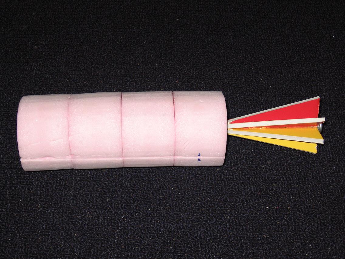

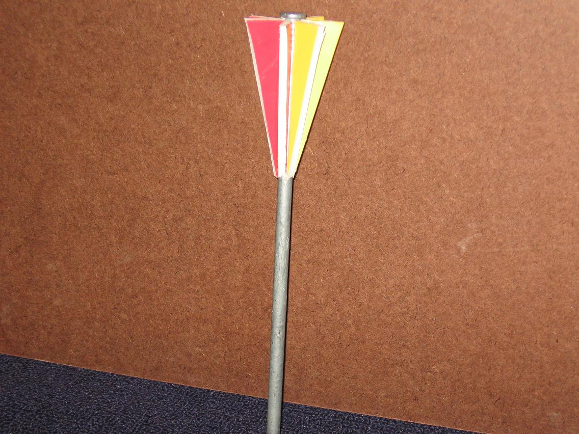

I've built exactly what you are looking for. I used a 1 ft concrete nail for the body and seven foam core boards for the fins. I used 2 inch foam board layered and cut in half for a sabot and barrel piston. Maybe I can get some pics up... now where are they...
EDIT: Ugh school sucks, can't find a picture on these computers but I have a link showing the design.
http://www.spudfiles.com/forums/viewtop ... tml#159270

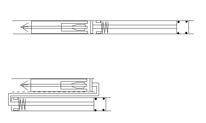

Adding to BTB's idea - see attached. I don't see how you could use a sabot and have something stop the piston without separating it like this?
- sealed barrel1.jpg (19.62 KiB) Viewed 5310 times
