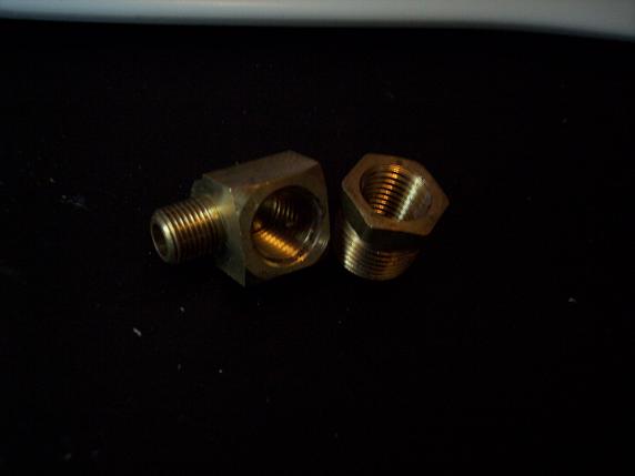

the bushing makes the threaded hole on the potato gun bigger , while it maintains threads on the inside of it (same as the outside of schrader valve). Metal threaded into plastic is not safe to screw in and out a bunch of times so using a reducing bushing made of brass or steel makes the friction point a metal to metal contact, not metal to plastic which will eventually get stripped out
the picture should help you understand this. the bushing he's talking about is on the right hand side, notice the threads inside and outside the fitting. the elbow on the left would make it fill faster if the valve was screwed into the bigger threaded piece and the smaller threads were screwed into the chamber because it would reduce the flow of volume
