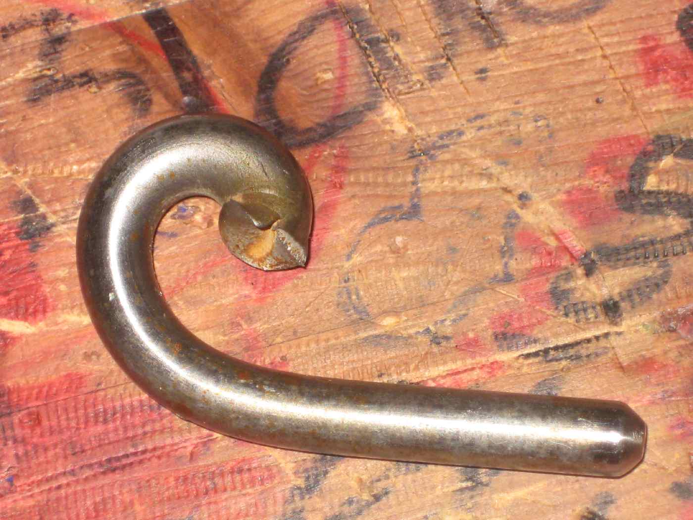

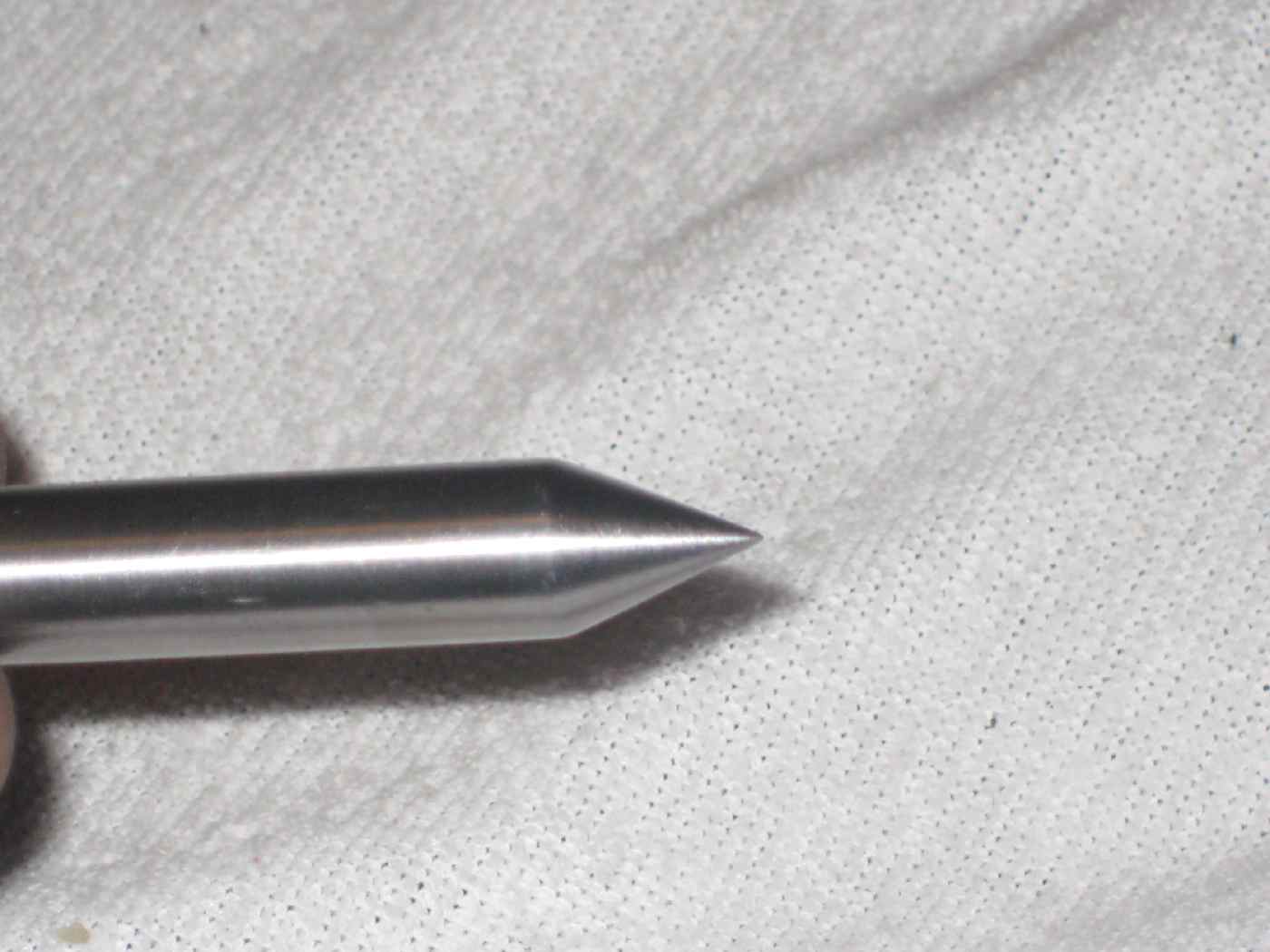

from previous testing on stainless steel i have found out that a shallow angle on the point of a dart will make it bend or split like banana even at 3x.
so what would be my best bet on 15yards? a steep rock hard point or a really pointy shallow angle that will bend easier?

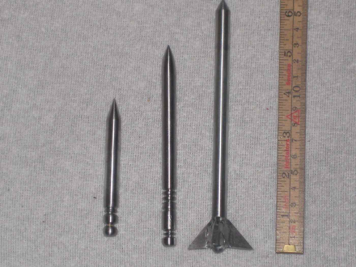

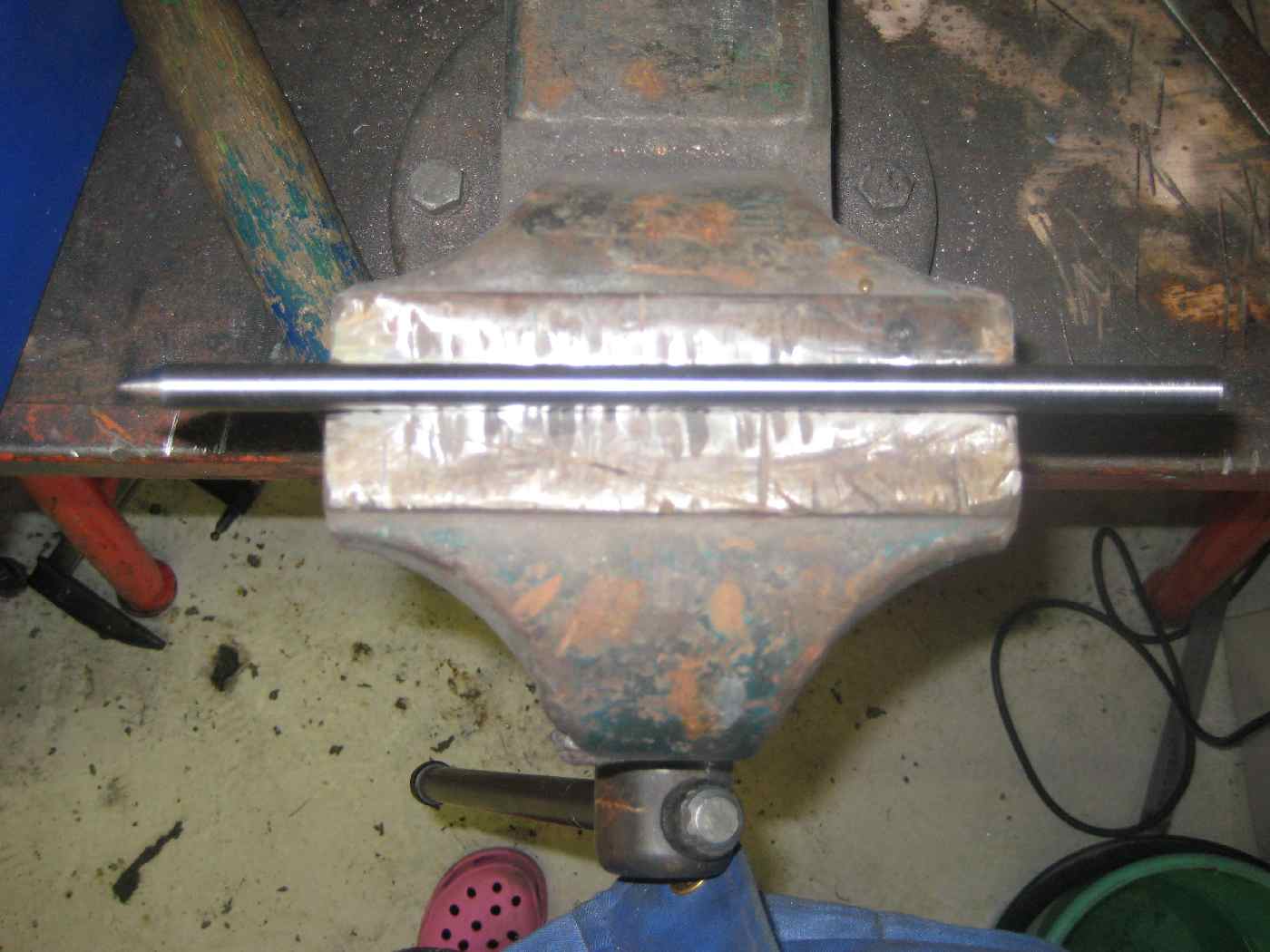

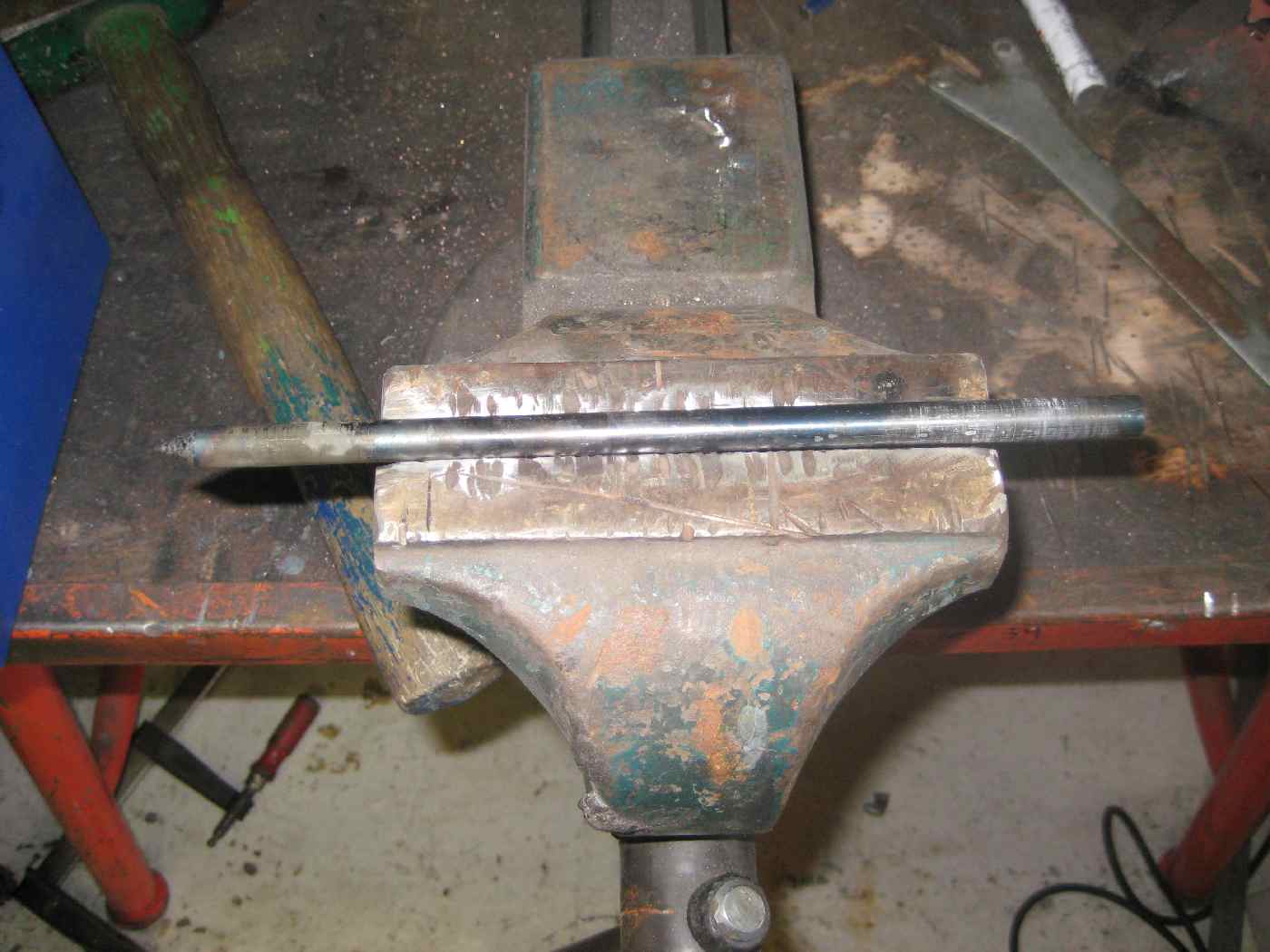

i have made only one dart i think can make it, and that would be the biggest one in the picture. it has a pretty steep angle but it has some energy also.

that would be the ghetto dart i think. (do you remember how shiny it was?)

Looks like the steep point is acting like a hollow point sort of only sideways. The tip being steep is weaker (less metal). So for those I'd say the shallow angle should work better.

I would say the tip should have an angle of about 60 degrees, maybe a bit more, it should give you a nice mix between sharpness and strength. Think of it like a chisel, for soft woods a shallow angle is better because the wood is soft so it doesn't break the weaker edge as quickly, but for harder woods a steep angle is better because it is still sharp but the edge will not be broken down as quickly by the hard wood. So judge the angle by what you are going to be shooting at with it.

@ spudfarm, I think the angle on the "finned" dart will be best for the intended purpose. The shorter the tapered portion is, the more force it will take to change its shape.
Also, how are you heat treating and tempering your darts?
The dart you showed that had been fired, looks as though it was still pretty soft.

hotwired: it is made of a rusty 1cm thick rod that i polished, what i fear with the tungsten tip is that it gets toren open around the tungsten tip.
thunderlord: when i hardened my dart i heated them so much that i could see the cracks in the steel on the red glowing steel and then dropped them in water.

I've been looking over the numbers. For something like this, a good point angle is in the 25-30 degree range - strong enough to take the forces involved, but sharp enough to be able to penetrate.
If you've got a tungsten point, you might even want to go down to 20 degrees, but don't exceed 30, you're making trouble for yourself if you do.

i will take your tips ragnarok, i think i go for the 30 and 35 degree with tungsten tip and look what it does.

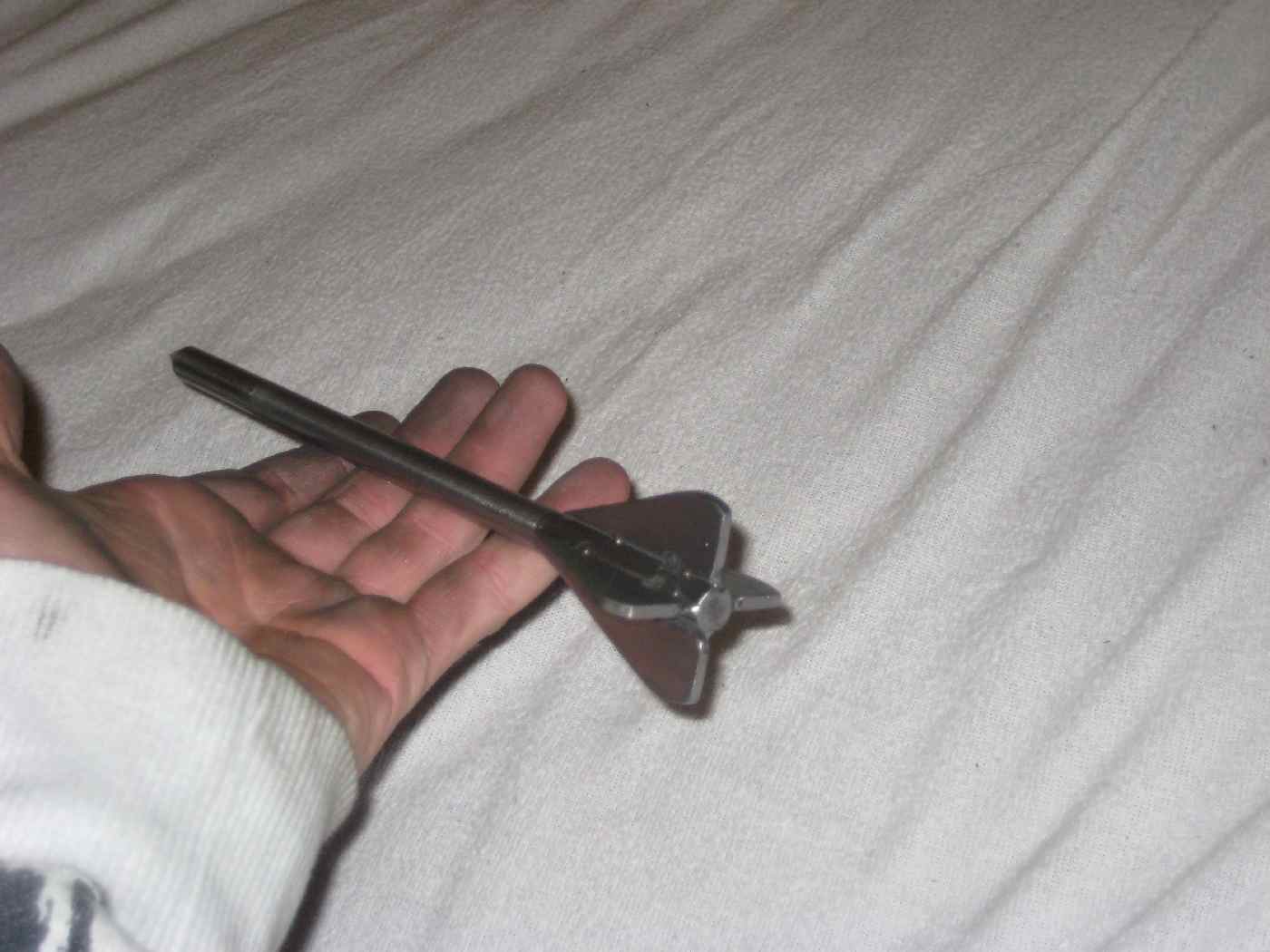

SpudFarm
Posts: 2571
Mon Aug 04, 2008 10:11 am
the electrode i has is harder than stainless since i shot through 1/4" stainless with a electrode. and the part of it that went through did not have a scratch.
(i did not have a drill on 2.5mm so the tungsten will have to wait)
ramses: those roundr are make with high accurate machines out of tungsten carbide and i have a pic of 50cm of steel one has penetrated.
i just made a bigger dart now and will post it as soon as i have resized it
edit: pics
hardened not polished
polished.. (halfway i just used sand paper there and not a polishing rag)

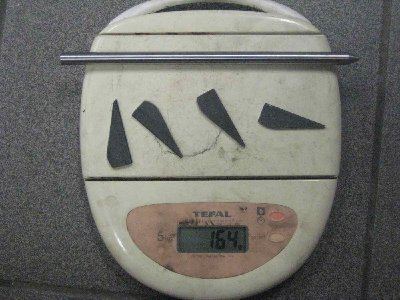

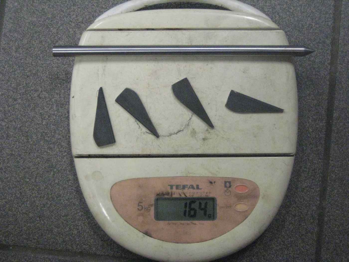

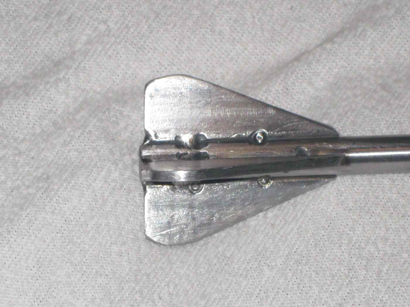

look at the fins and the penetrator<br /><br />(164g)
(164g)

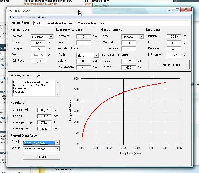

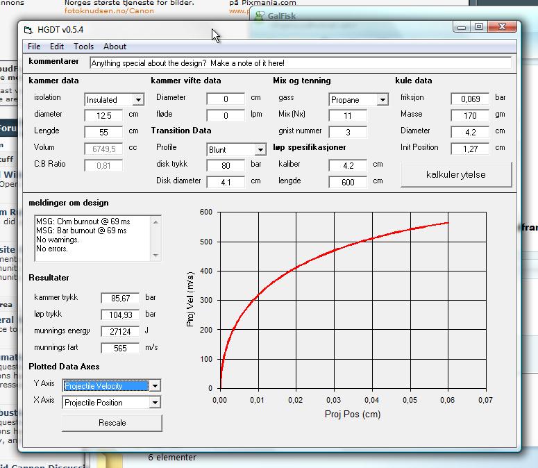

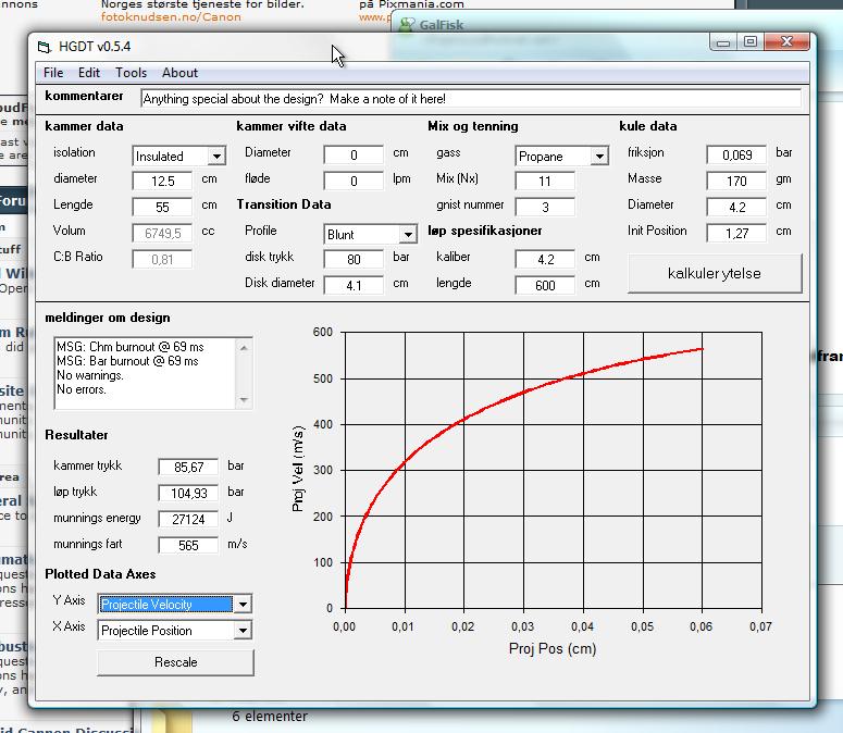

wellwellwell 27k joules :)

Mon Aug 04, 2008 12:52 pm

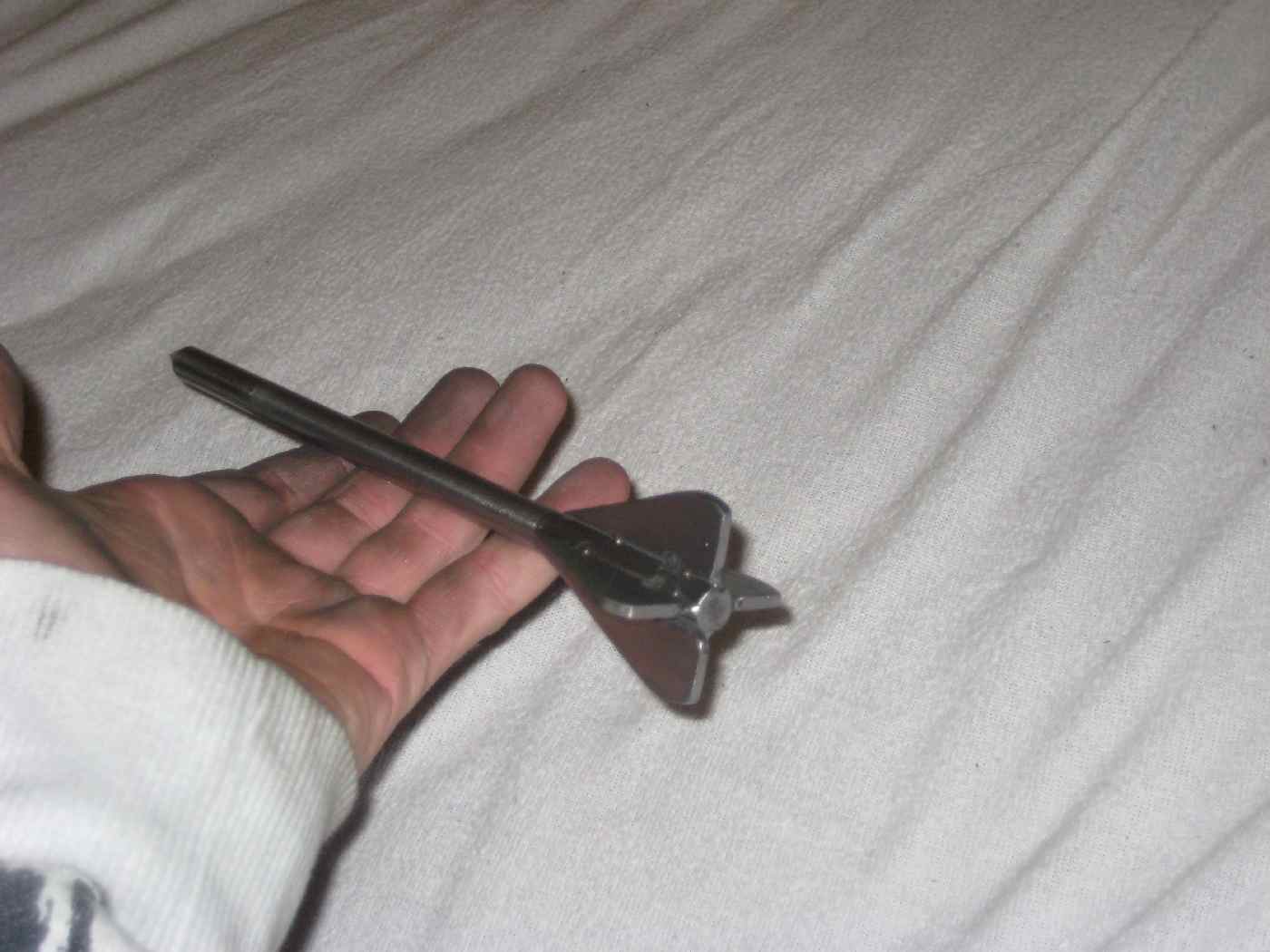

well i got the fins to stick on the dart..
i think those fins will fall of when they hit something (if they even survive in the barrel)
well, i am pretty pleased by the outcome of this, looks pretty cool eh?
that would be the angle, it is slightly more shallow than the other fin stabilized dart
