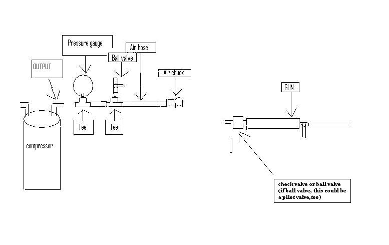

[img][img]http://img23.imageshack.us/img23/5512/73381710.png[/img]
Is this setup right or do i have to change something?

ramses
Posts: 1679
Mon Mar 30, 2009 1:28 pm
no, this is better. I would use quick connects instead of schrader.

ramses
Posts: 1679
Mon Mar 30, 2009 2:01 pm
I have seen them used to higher pressures more often, so I conclude that they would be less likely to fail, especially if you use salvaged male schrader valves from tires or something.
also, make sure the hose is rated above you max operating pressure.
psycix
Posts: 3684
Location: The Netherlands
Mon Mar 30, 2009 2:47 pm
You can use a shrader, but I had a lot of shrader chucks that leaked. Quick connects seal better and work fine on high pressures. You just need to bleed off pressure before disconnecting, thats all.
Ramses is right about the ballvalve placement.

Ramses's design is good i know but i want to change the design so is this good or should i change something?

Sat Apr 25, 2009 9:55 pm
@roughboy
so does it work with a starting relay ??
this design is better as there are two 'out going' ports - one for a bleed valve/ball valve and one for the air hose...
once you have time to improve your setup you can add one more T to get one more port for an air tank ( it's a really useful addition - just make sure it is rated high enough)
I know that psycix told you that before but it's worth stressing -> use quick connect fitings... it's easier to get a good QC fittings than shraders... and it makes life easier in the long run
there are QC fittings that are specifically designed to work with higher pressures - but you can use normal ones
inonickname
Posts: 2606
Sat Apr 25, 2009 10:59 pm
I repeatably use schraders to 300-400 psi routinely, but they are clean, unused and brand new. Air chucks are rubbish, so if you're using schraders you need a screw on connection such as in shock pumps. Quick disconnects are the best in my opinion.
