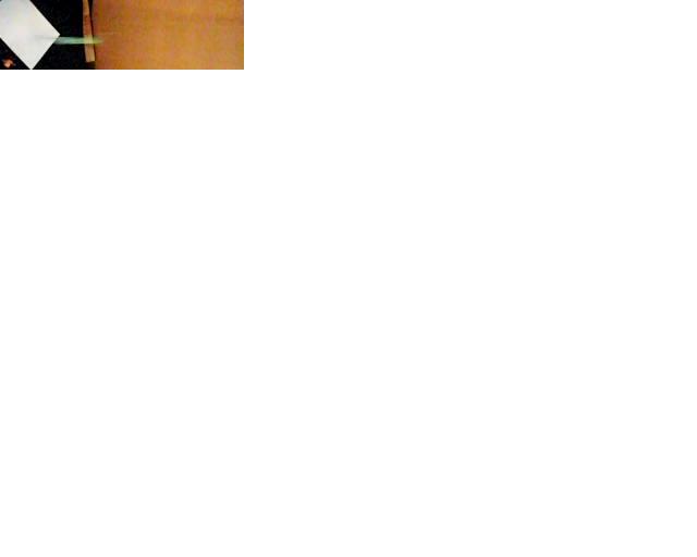

Tail shape in flight.
Captured from AVI using Virtualdub.
Notice how cylindrical the T shirt tail appears.
P.S. The head of my 10d nails measures .36 caliber.
