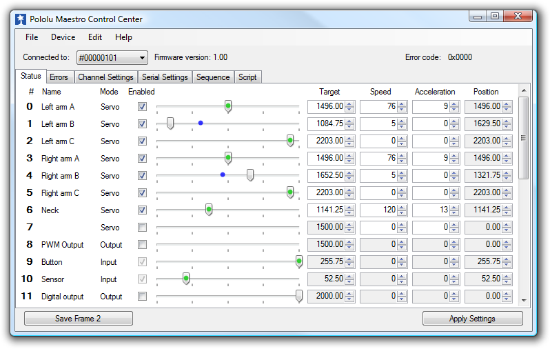

Before abandoning the one interface due to the programming, take the time to examine the manual and see of the software is going to be too difficult.
The User's guides are at the bottom of the page.
http://www.pololu.com/docs/0J40 User Guide
http://www.sparkfun.com/datasheets/Robo ... 091221.zip
Windows Software
http://www.sparkfun.com/datasheets/Robo ... 224.tar.gz
Linux Software (may work on Mac OSX 10 or Snow Leopard)
