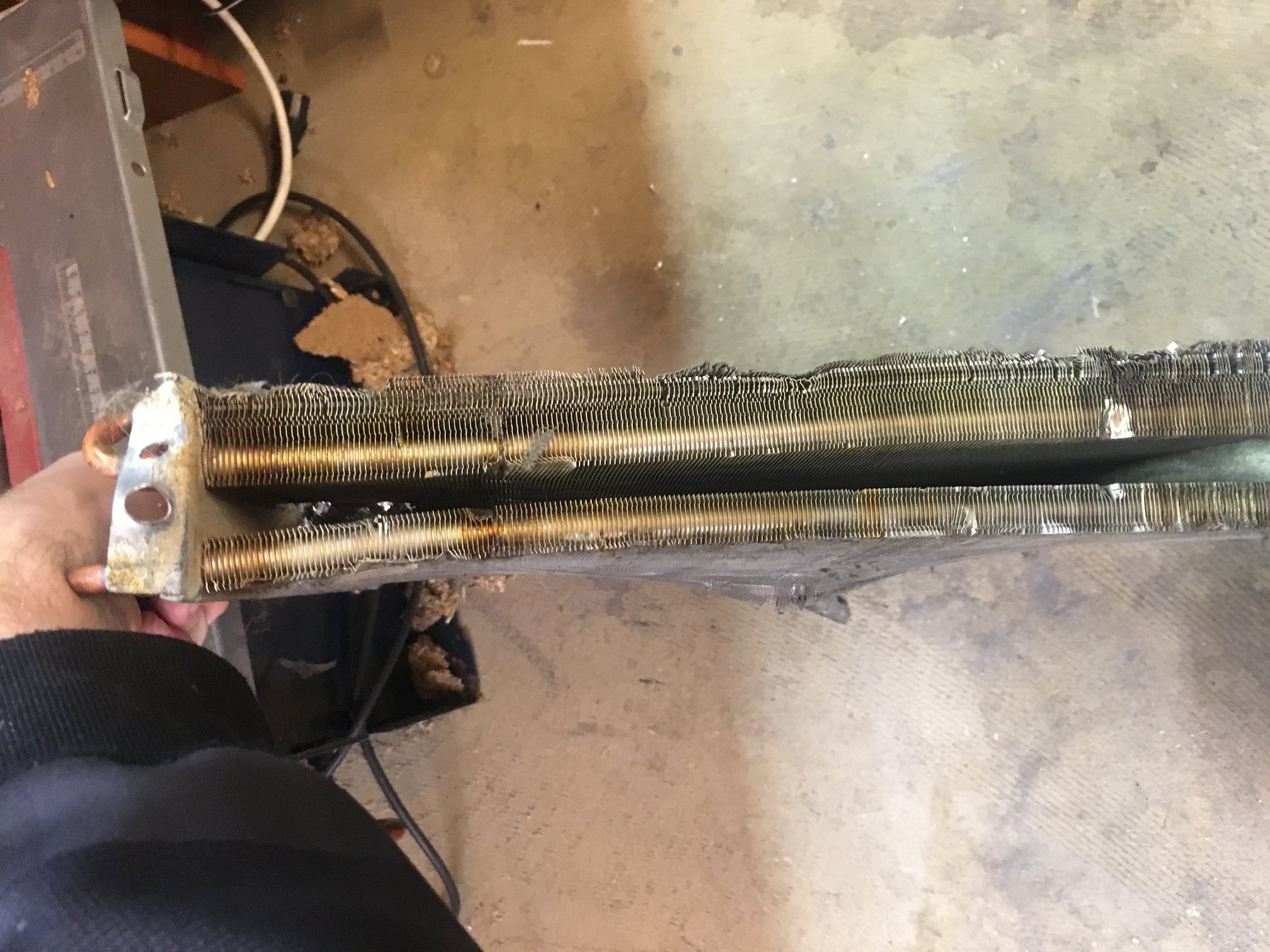

Did a few test shots at 40 bars on an old aircon radiator.
The particle board i used as a backstop is about 38mm thick. I also took a shot at the board without the radiator and it went clean through even tho the projectile impacted sideways. The projectile is made of 20x 25mm washers held together with a 35mm M6 nut and bolt.
