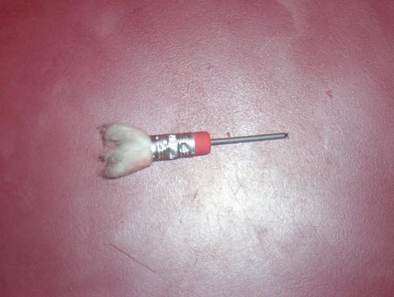

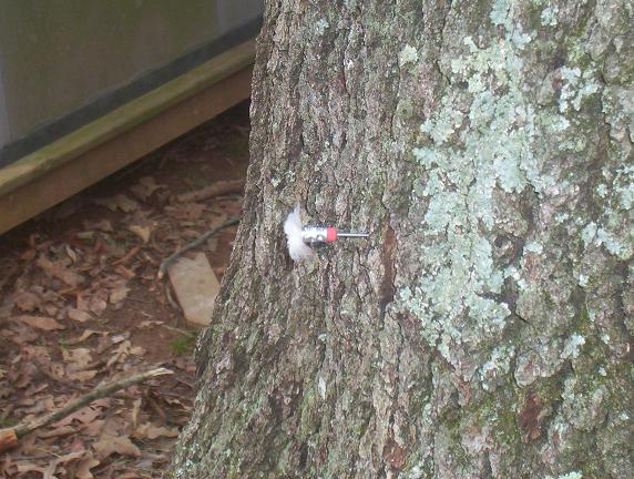

i made a dart out of things i found around my house last night and wanted to share it with everyone
heres how i made it:
1.take the metal part and eraser off of a pencil
2.unroll a cotton ball until it will fit into the back part of the metal thing (you could also try using an unused cigarette filter)
3.now you need a point about an inch or so long, for this dart i used the metal rod of a rivit, before i used that i used a straight piece of a paper clip but that bent to easily, you could also use a nail (i didnt because i couldnt find one lol)
4.now just stick the point into your eraser and glue the cotton ball into the back of the metal part of the pencil(any glue will work, i used super on mine)
this dart fits into a .5" barrel and flies really straight and far
shot at 20 psi at 60 feet

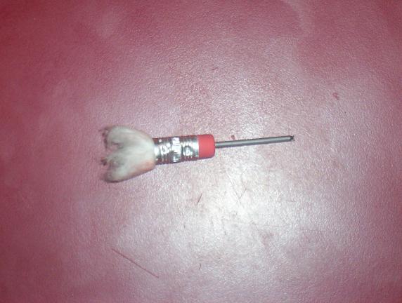

the dart
the dart

Thats pretty awesome :D . Have any ideas for a 1" barrel?
Deko
Posts: 190
Joined: Fri Sep 29, 2006 3:22 pm
Sat Dec 02, 2006 1:54 pm
a roll of coins or just some coins glued together, not sure what kind of coin would work best though, just find the biggest coin that fits in it, may need tape

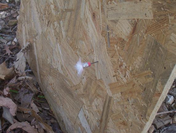

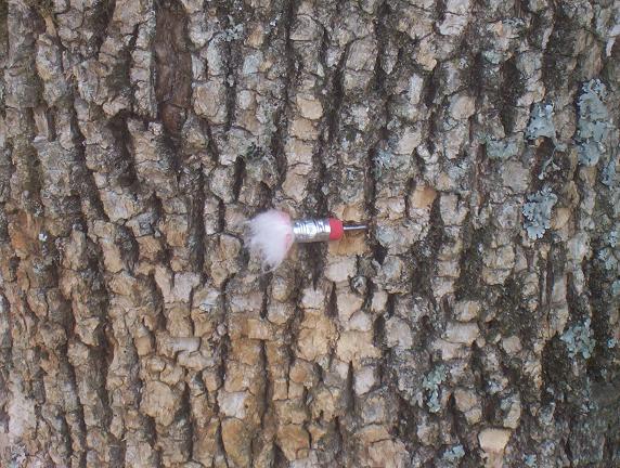

heres some more pics
30 psi at 80 feet
30 psi at 80 feet
20 psi at 40 feet
20 psi at 40 feet
