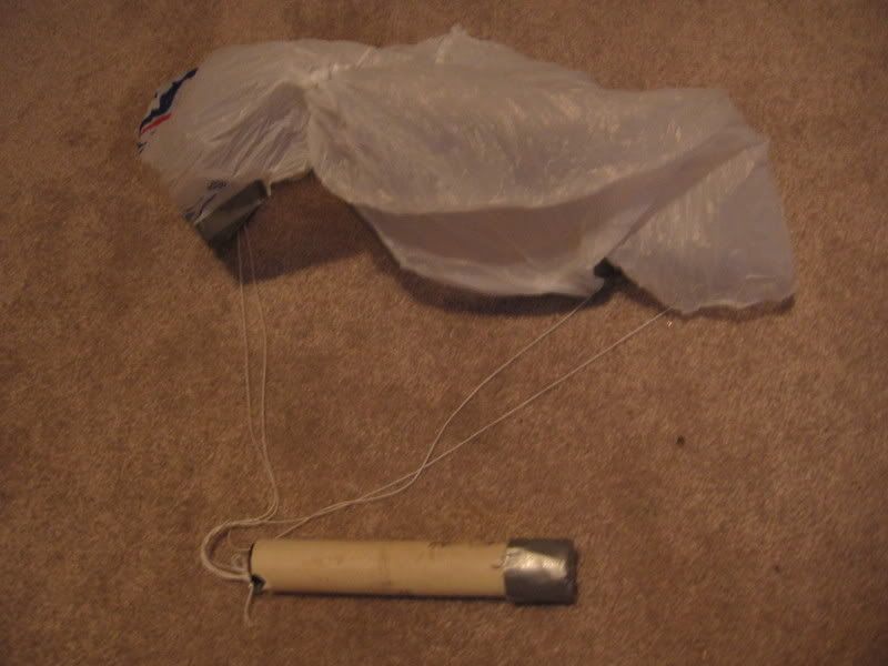

How does that work? Wouldn't the parachute just open right away and stop the projectile from going very far?

sorry it took so long for me to get the pics but i didnt have acess to a camera for a while
no it doesnt open up right when shot or thrown it goes and comes down about 5-10' before it opens
and heres the pics:

Very nice, I'm going to make a smaller version for my gun, I'll tell you how it turns out.

EDIT: insomniac how long are the strings on your chute? try making the strings:chute ratio 2:3 that seems to work best for me (i failed several times before i came up with this) or it could need more weight cuz im not sure how much that weighs
or its possible the problem is the way you load it, heres i prepare mine:
grab the very center of the chute so it falls into a cone shape the just squeeze it and get it as skinny as you can then fold the tip of the chute to the bottom of it and squeeze again the wrap the strings as tight as you can around the bottom of it (where the top meets the bottom) and then fold it over next to the load or put in front or behind the load to shoot, try different things and see wat works best with that size ammo
