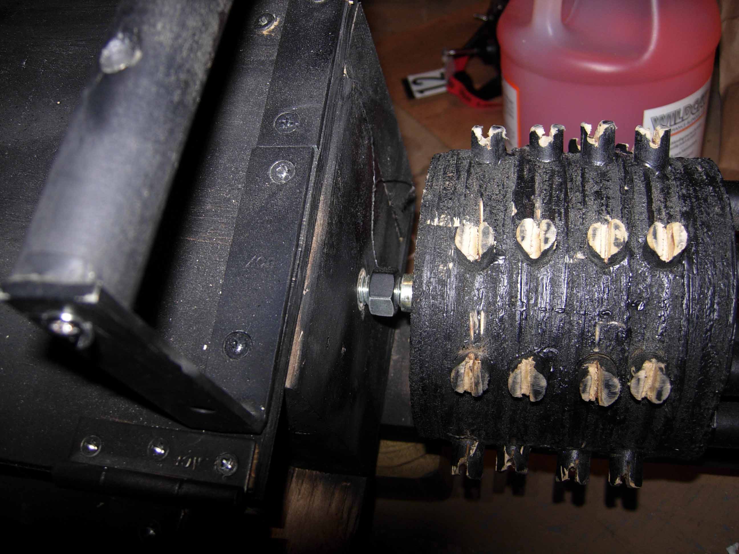

sounds like a good design, for th barrel I cut plywood into circles, and glued them together untill I had a cylender about 8 inches long, then, I drilled 8 holes for 1" poplar dowels to use for the individual barrels, after gluing them in , I cut more circles, and drilled them with the same hole pattern as the barrel's base, and then used them as barrel reinforcements. After this, i drilled 4 holes behind each barrel and mounted poplar pegs in them, after this, i cut the slots with a dremel, and then sanded them smooth.

here are some pics of the barrel in more detail
the barrel reinforcement
the motor (notice the string "trigger")
the rear barrel and mount
the front barrel mount
the front of the barrel

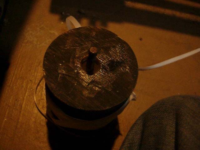

the spool
the spool
