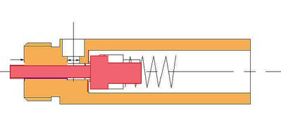

but couldn't you just make a valve like the hammer valve in Gippeto's co-ax ??
could you get a piece of solid ally drill your center hole 3mm and then drill your port in the side. place 2 o'rings either end of the solid and a grub screw hole in the middle between the orings then slide the valve down into your chamber and grub screw it in place. (ruff version)
then all you need is a snug fit pipe/tube to go between your valve and breach ?

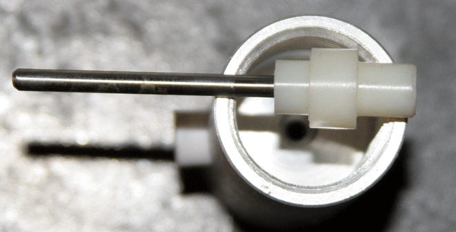

the hardess part i think would be the seal , all real pcp guns use (sorry to all but most) delrin plastic as there seal. i think this could be possible
here are some excamples, from real pcp guns
