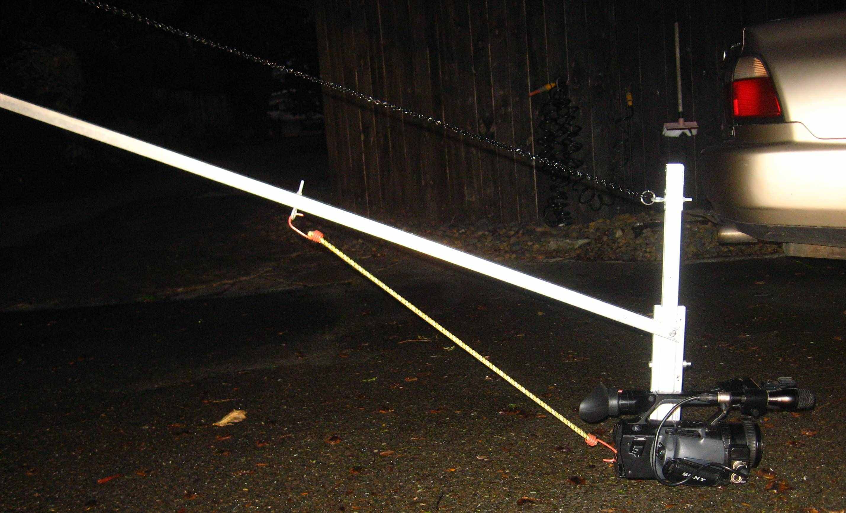

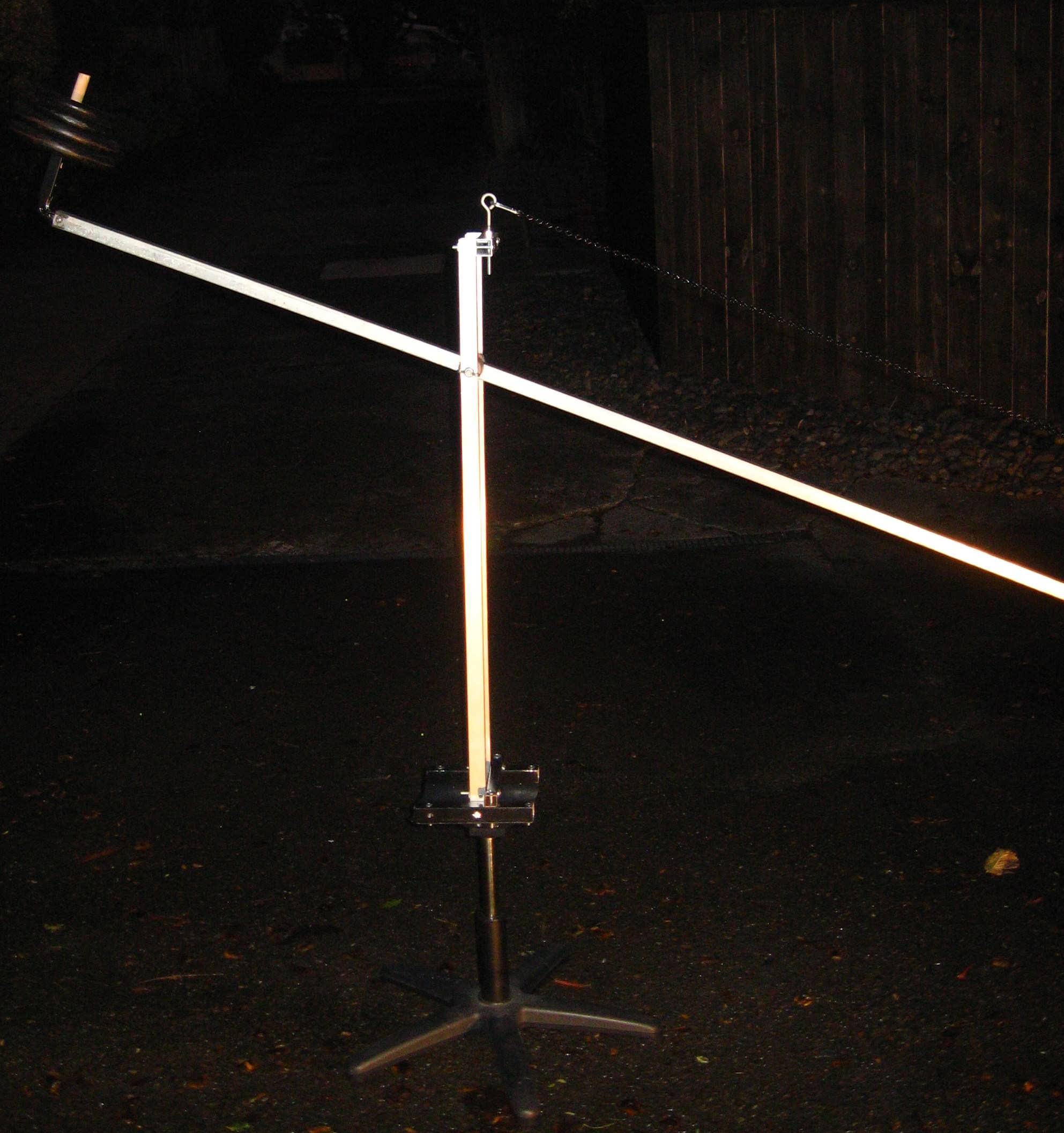

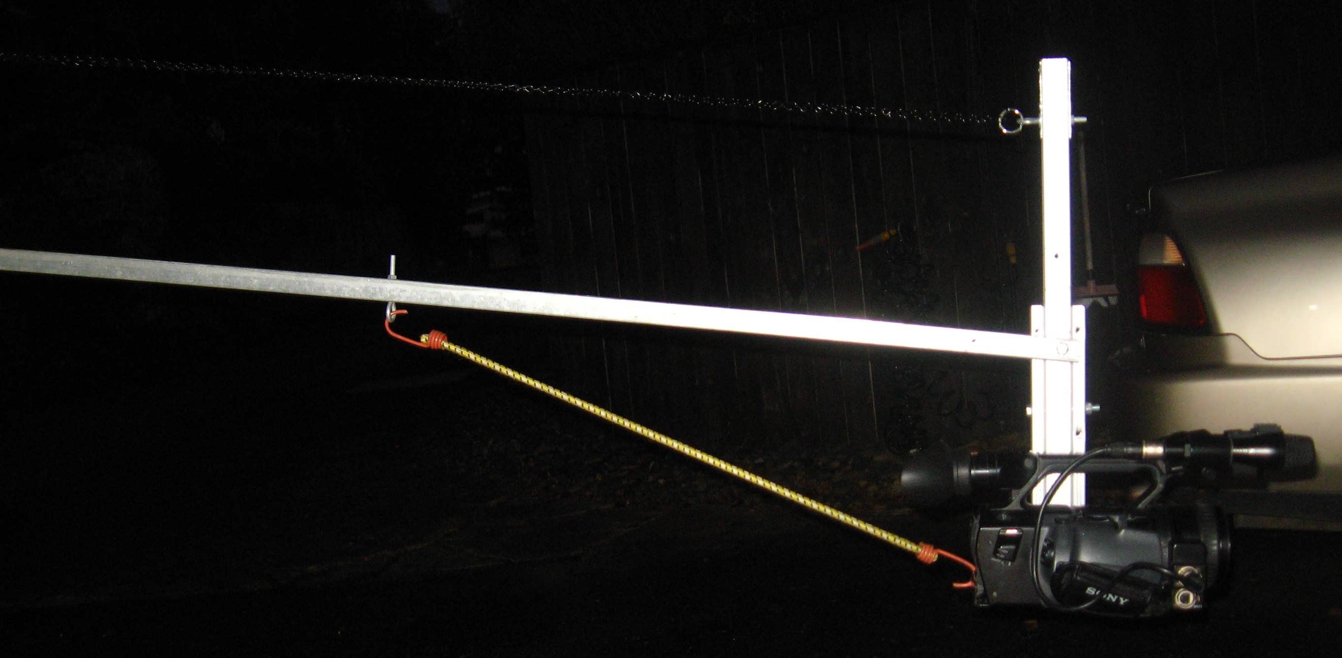

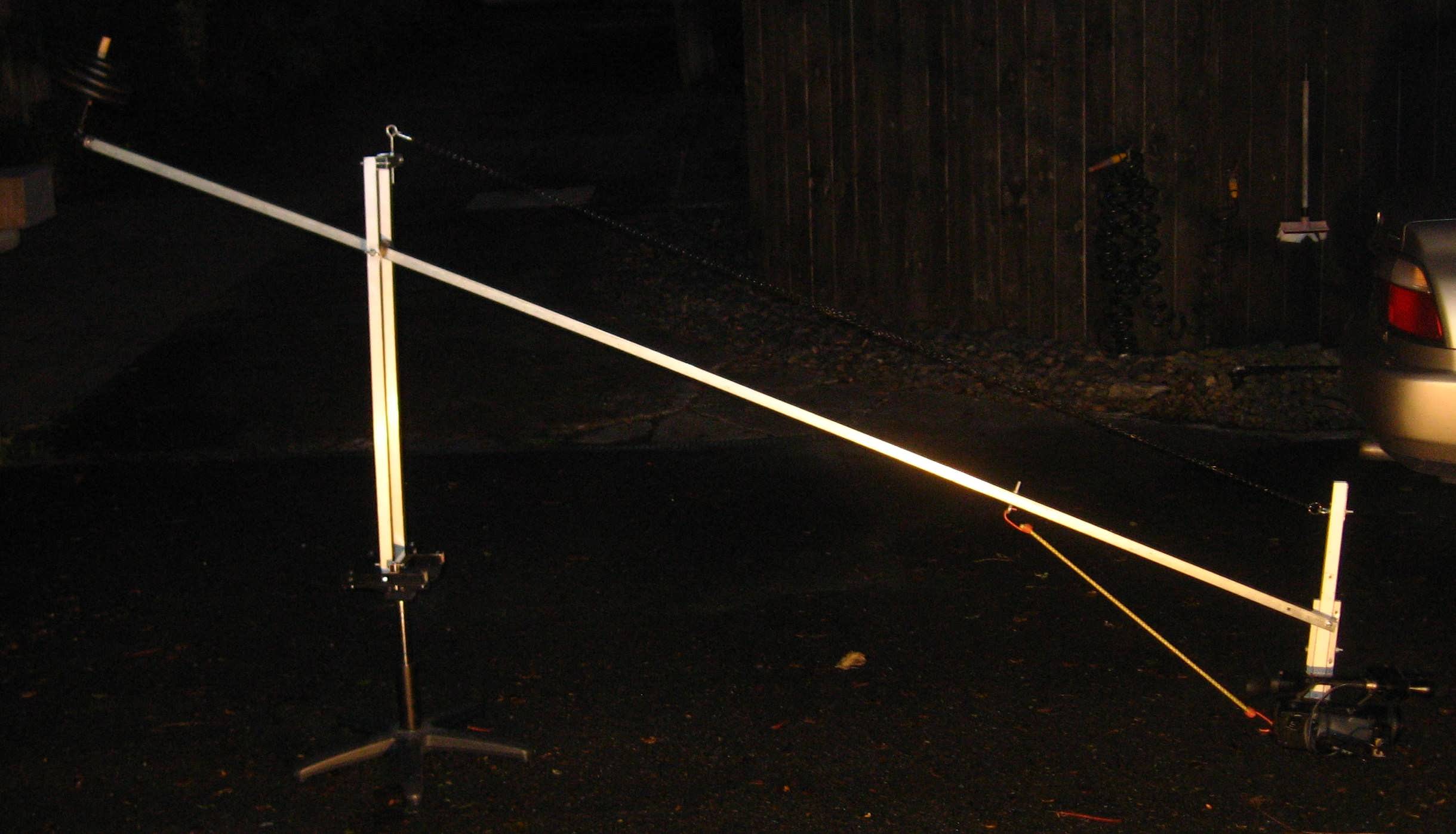

A little project i've been working on. So far it has cost me $50NZD ($35USD) and I still need to buy some spray paint for it. My friends and I do a little filming just for fun/as a hobby so I thought i'd give a camera crane a go. Wasn't too difficult, you just need to make sure everything is straight.
Crane can turn 360 degrees, reach a height of about 9' and the camera will always be level. The base is a computer chair, pivot is just a big bolt, has 7.5kg of weights on the back and the camera mount is just some bolted metal from a golf trundler and a TV mount haha. It has a chain which can be adjusted to allow for different camera tilt angles (or as shown in the pictures, made to keep the camera level). The bungy cord helps remove the slack in the chain (by pulling the camera back) as the crane arm tilts up. This also helps to keep the camera level.
If anyone wants more pictures, I can post some later. Maybe even a video. Apart from that, anyone have suggestions for improvements?
