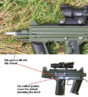

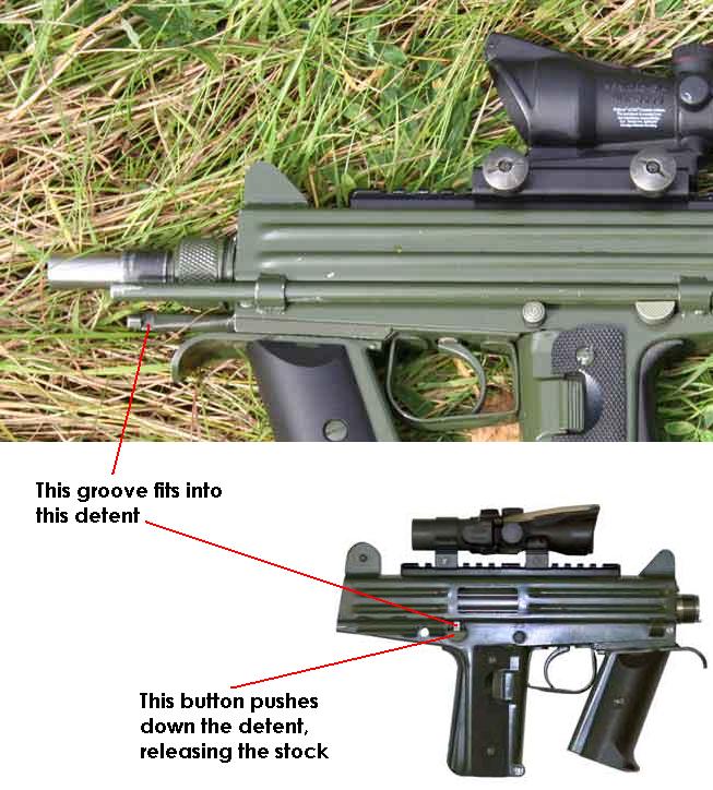

How do stocks like these- http://world.guns.ru/smg/smg101-e.htm
stay locked in one position so they don't just collapse down? Wasn't able to deduce it from pictures.
how does this stock lock in place?
Easy

If you were making one a spring loaded ball bearing would probably work ok.

maybe its like the handles on a scooter, spring pushes a pin thru a hole
Jack hit the nail on the head, that EXACTLY how it works.
