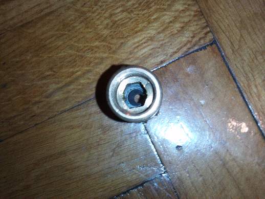

homemade compression fitting
you put it onto the tube and tighten... rubber washer gets squeezed and holds it in place as well as seals perfectly

Sat Sep 29, 2012 1:03 pm
cut the copper tube off at the shell and weld a fitting onto the shell around the copper.

Sat Sep 29, 2012 1:51 pm
duh guess you've never seen inside of a fridge compressor... that doesn't make any sense at all
compression fitting is the best option - if you have to you can remove it easily

Sat Sep 29, 2012 2:25 pm
I use mine upto 100 bar and its fine, theres a thick plug that the copper is brazed onto on the shell Image

Sat Sep 29, 2012 2:30 pm
well you had to braze the copper tube into the fitting otherwise it won't work as the shell is exposed to the inlet

Sat Sep 29, 2012 2:35 pm
no it was already brazed, I only welded it because the copper tube snapped off at the shell

Sat Sep 29, 2012 3:15 pm
ohh around the copper tube stickign OUT of the shell... sorry I understood you suggested drilling a hole and welding a nipple there, which obviously wouldn't work
