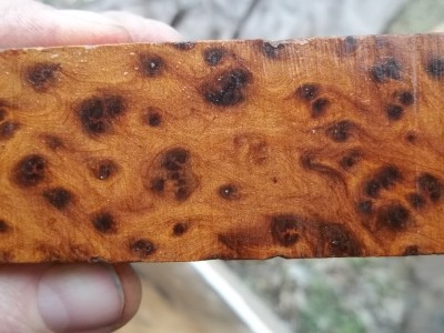

Ok, by the way Anatine Duo, can you post an image of your stabilized burl piece?

first photo... I hope

That's pretty neat, though I like more colored stabilized wood, even though your does apparently have a brownish color, I really like a green, blue, red or a black too
