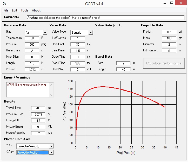

Currently I have a 40" barrel. How far from the base should I drill the holes to vent the barrel into the sleeve? Once I get it together I will experiment to see if I need to extend the barrel and the sleeve.
The best place to put the vents is just after the projectile reaches maximum velocity in the barrel. If you put them before, you'll lose performance, if you put them after then the deceleration wont be optimized. This point will of course vary according to weight of projectile, firing pressure etc.
You can see it in this simulation at about 14 inches in a 40 inch barrel, using a much smaller chamber:
Note however that the chamber is much smaller than the on you're using. You really should aim for a small chamber at high pressure as opposed to a large chamber at low pressure, because the latter will not give you good enough acceleration.
For the above example I halved the chamber volume and doubled the pressure, technically the same amount of air - but we increased velocity by 12%:
I really recommend plugging numbers into GGDT (That I don't think we than D_Hall enough for!) before starting construction, it will save a lot of trial and error and wasted PVC.

Attached is my first try with GGDT. What do you think? I use a MAC so I had to dig out an old PC notebook to run the program.
Sorry for the flaky file but I think you can read it. Looks like I the 1/4" holes (vents) 4 of them should be about 25" from the base of the barrel.
Hope you can open the file.
Sat Apr 08, 2017 9:45 am
It's really hard to read the data, can you get a better screenshot?
25" looks about right for maximum acceleration assuming the barrel is 40 inches long. You're going to need more vents for efficient braking though. The barrel cross section is 3.1 square inches while 4 x 0.25" vents is 0.2 square inches...

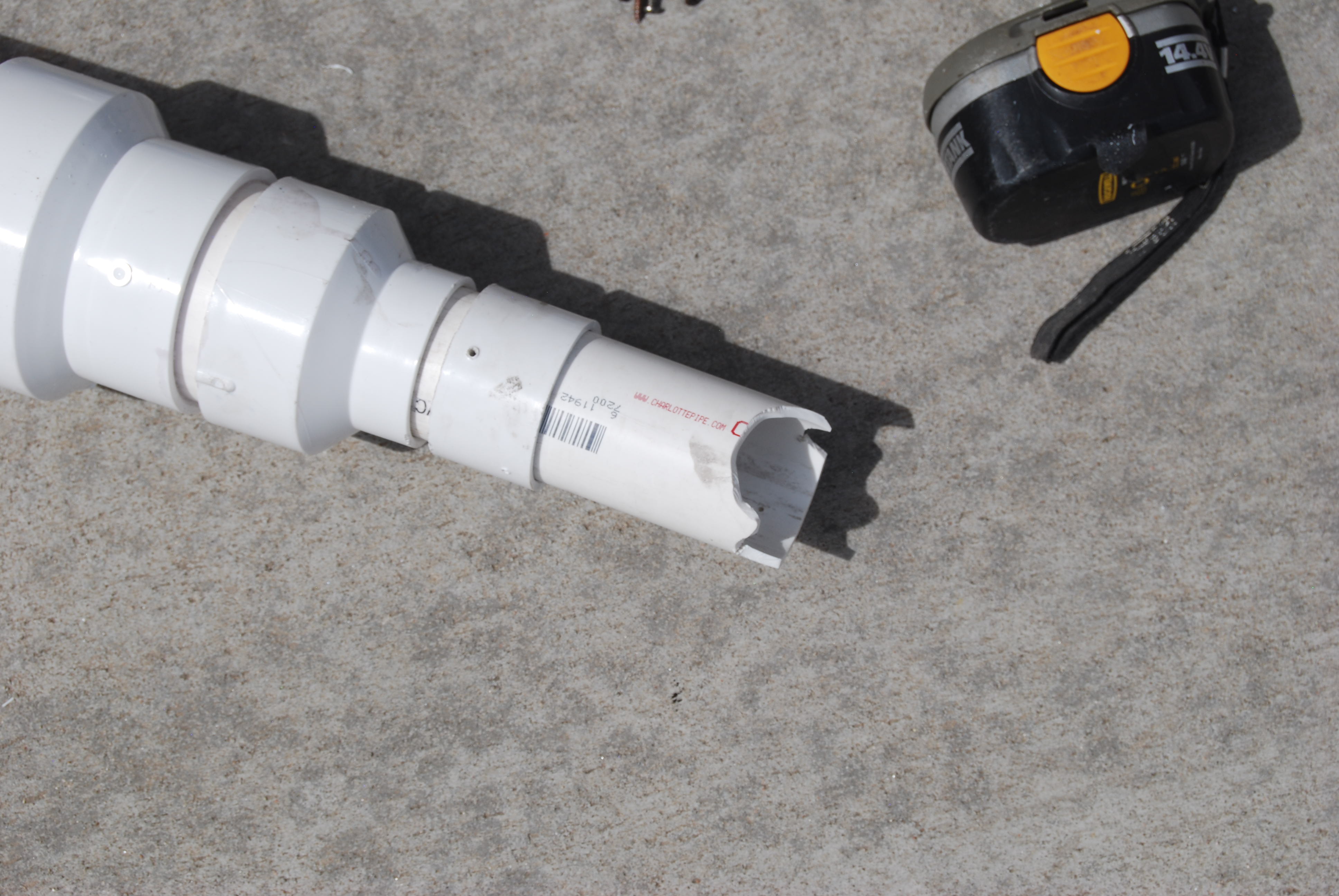

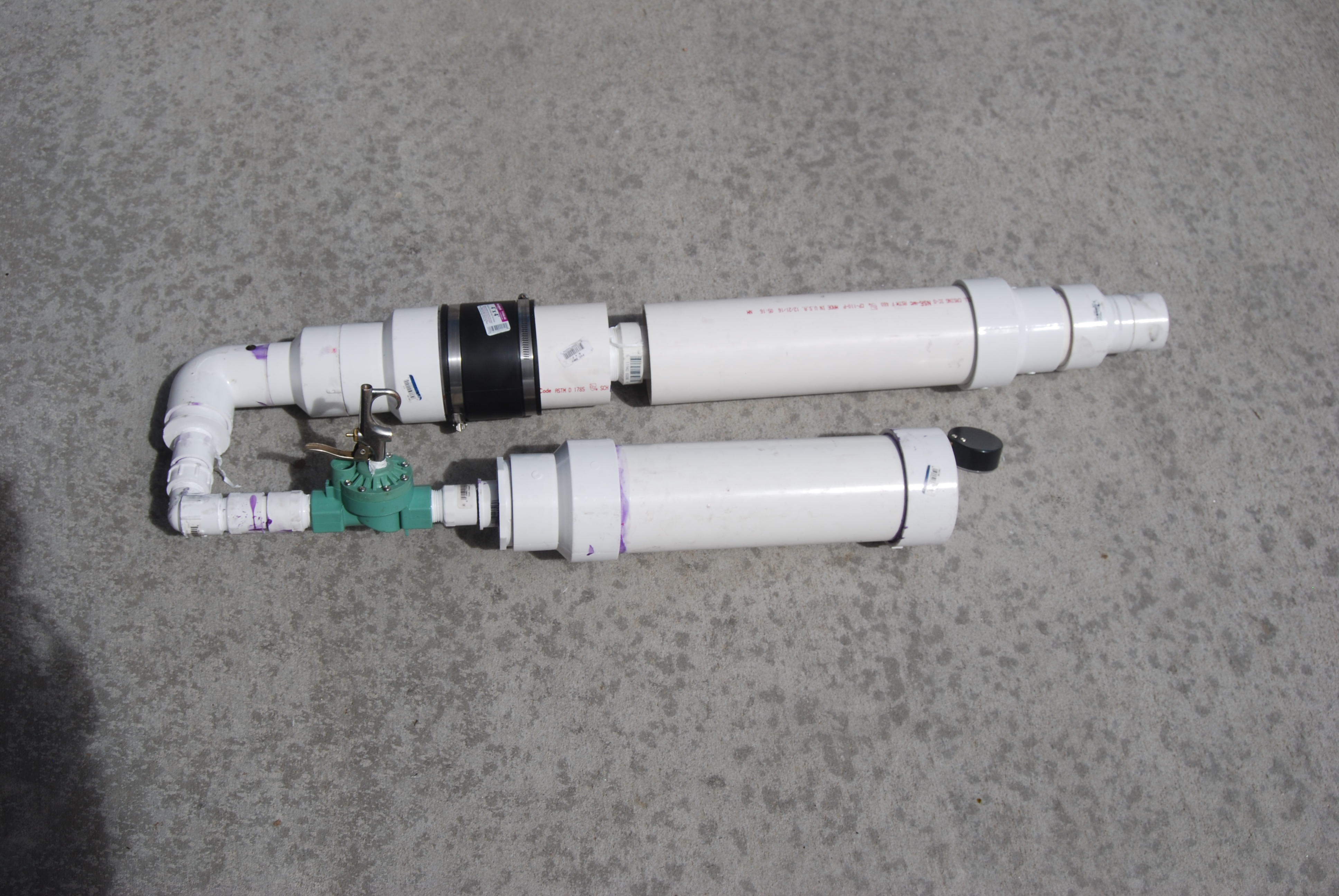

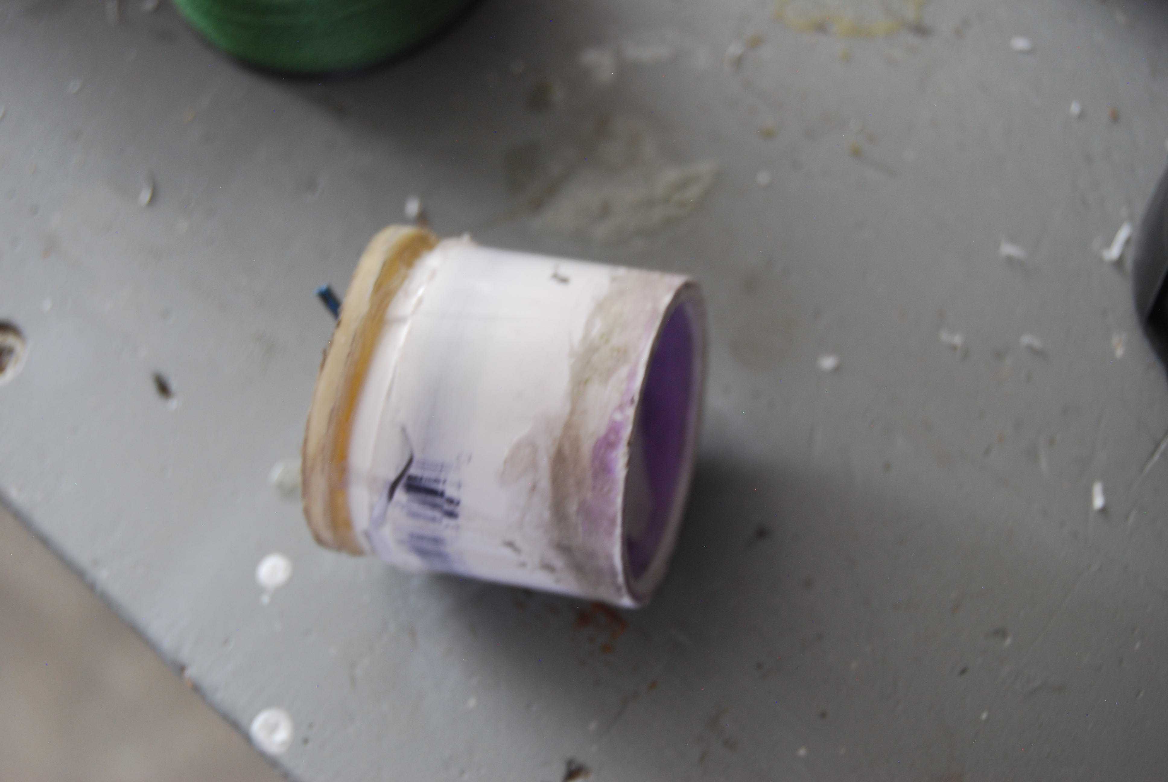

Tested it today. Drilled 4 3/4" holes in the 2" barrel. Put an arrestor on the end. Pumped it to 40#. The lightweight pvc sabot, made from a 1 1/4" end cap (about 2 oz) blew the arrestor off. See pictures.
Don't know where to go now....
Thinking that finding out how to make a biodegradable sabot may be the solution. Any suggestions on how to do that would be appreciated.
Mon Apr 10, 2017 9:39 am
Did you fire it with an empty sabot? It's critical that is is full because otherwise it Will accelerate much faster and put more stress on the arrestor. In any case as previously stated your chamber is far too big vis a vis the expansion space to be very effective.
That being said, perhaps if you're more concerned with the fishing than spending too much time doing launcher r&d perhaps a biodegradable sabot is the best route. Surely a papier-mâché paste using water, flour and newspaper to press cup shapes would not be too difficult? http://www.ultimatepapermache.com/paper-mache-recipes

Mon May 08, 2017 1:15 pm
Progress. Had fun in Galveston. Tried out the launcher and it worked well. Made some changes upon our return. Replaced the sprinkler valve with a 1" brass valve. The sprinkler valve has a tendency to leak if any particles enter the valve. The brass valve works just fine by simply hitting the handle to open it. I tried a PVC valve at HD but it is stiff and hard to open quickly. Did use 2" diameter, 1" thick cut potatoes as a sabot of sort. Worked well. I am going to try to manufacture paper mache sabots as a biodegradable alternative to the potato. They would fully enclose the bait package.
I replaced the PVC barrel with a schedule 40 2" ID aluminum barrel. Got it threaded at ACE hardware ($2.50).
HD was not enthused about helping me.
incorporated a PVC stand and rod holder. Used 2" PVC Snap Tee ordered from FlexPVC. That will slide over the 2" barrel. Can't use a 2" Tee as there are stops that don't allow it to slide down the barrel.
Sat May 13, 2017 7:51 pm
Basic but it works :)
There are ways of spring loading it for more consistent performance. Also, consider mounting the ball valve at the end of the barrel to reduce dead space and increase performance even more.
