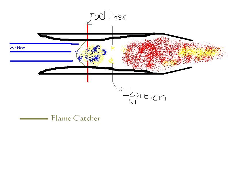

Don't get me wrong, you can make a ramjet work at subsonic speeds, but it's incredibly inefficient, kinda like starting a gasoline engine. A ramjet works best when the air flow into the engine is supersonic. At ignition the air flow needs to be reduced to at least subsonic. The lower velocities in the ignition chamber the more powerful and efficient the engine becomes. For the fuel, I would use kerosene. The stuff comes in bottles for outdoor torches. Kerosene is the same stuff used in jet engines. However, it doesn't light very well if its cold. Before making an engine I would play around with different ideas for ignition. I've got the idea for a chamber that significantly reduces air flow using a coffee can and a bit of steel tubing. It's not designed for prolonged use but rather a proof of concept model. The same design is used in homemade jet engines. It is almost a standard (if there was one) for homemade engines.trollhameran wrote:As i said In an earlier post, i didnt know a single thing about ram jets until yesterday, so your useful tips are much appreciated, I will be attaching an air source to the intake so that I can have air going through at high speeds and I will further research intake designs, but from what I have read so far I think it should work with a subsonic intake as i dont think a small car like this will go over the speed of sound, please correct me if i am wrong about the intake as you seem to know alot more about it than me. Also is methylated spirits an ok fuel to use? i'm not sure if it burns quick enough. I will be rebuilding the car soon, once i have more knowledge of the design elements, this was really just a quick thing i whacked together to test the things i have learned about ram jets so far, but the next model will hopefully be much stronger and more accurately put together
