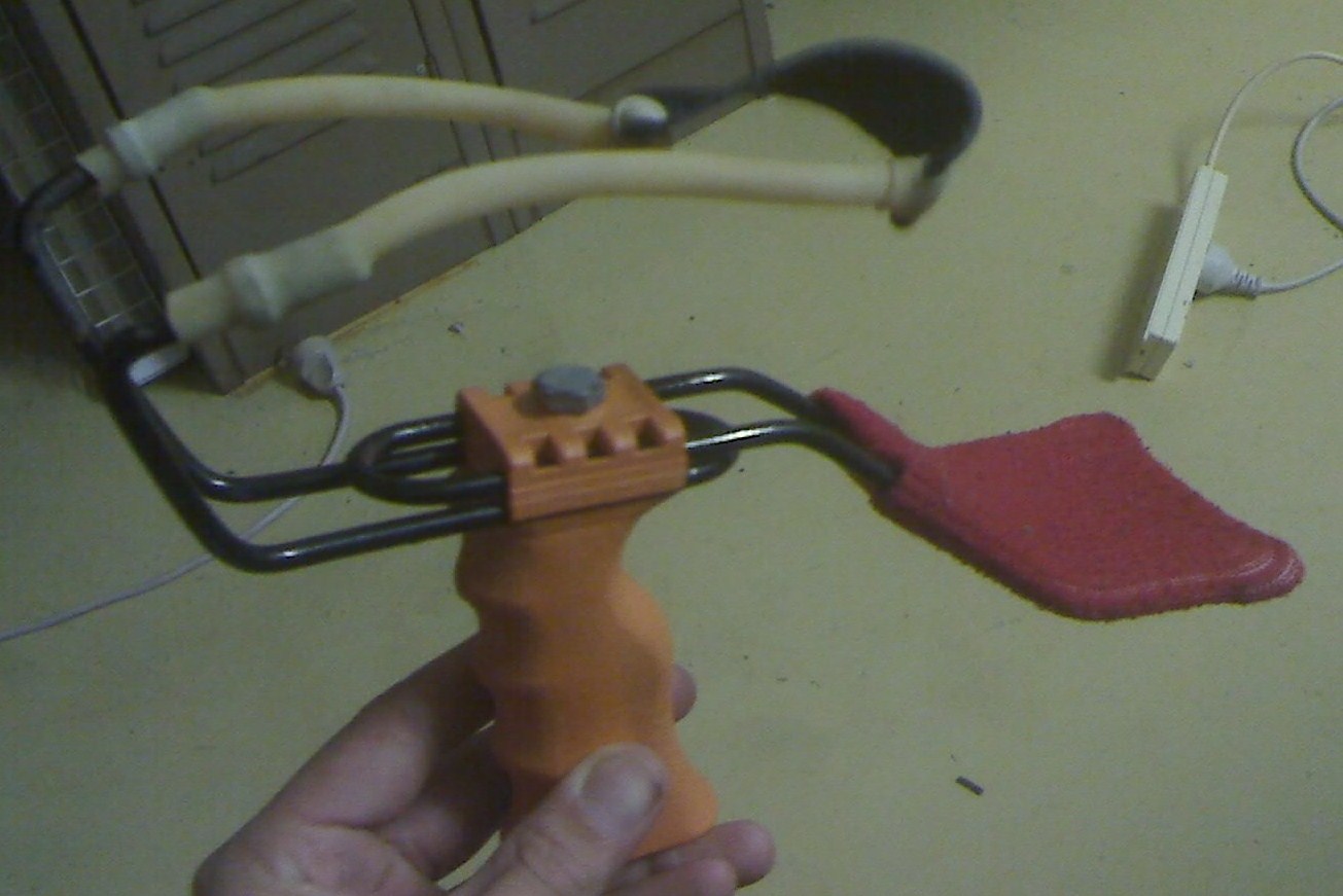

I have built a slinghsot today that does allow me to use Thera Band silver.
The key is a very flat profile over my wrist (braces are illegal where I live).
So I had to eliminate everything between my hand and the tube.
Still very stiff, but I can control it.
Thera Tube Silver is a bitch, very unforgiving. One knot not 100% tight - another welt from a slipping rubber.

Joerg,
That does not look like fun.
Drawing silver looks very dangerous.
Is there enough safety clearance from your fist to the rubber?
Above a certain power point, the rubber should not be able to hit you for any reason.
After I draw the silver with the BigShot (more than 300%), I can relax, aim it holding very steady, and pull the trigger.
My prototype is just a rough proof of principle, needing much improvement.
The neat thing was having it almost drawn and being able to hold the friction rope with one finger.
I wonder if removing the front pulleys and substituting a metal eye bolt would be better.
I could also use a string over design like your new silver slingshot ,and just let it all fly out.
Suggestions?

Stu,
it may not look like fun, but then again I am a weightlifter guy and managing to master weights that you could not do before IS fun for me.
The fly-over principle has the advantage that it is most accurate and the parts (string, rubber) last longer. Disadvantage: Reloading time is longer.
As for the trigger, may I suggest to use these clamp-on plyers? I do not know the exact name, but they are used by car mechanics. You can adjust them and they lock tightly, have an own kind of trigger to release.

JoergS wrote:Stu,

JoergS wrote:Stu,
http://cgi.ebay.at/Promat-Gripzange-Fes ... otohosting
Like this?
I believe that the leather pouch may be an issue as the power is increased. A single layer of leather may tear through.
However, with the vertical rubber orientation, there is little danger.
How would you beef up the pouch to take 200 pounds of pull?
Another possibility, is to take the tension off the string in front of the pouch. A double trigger mechanism?
With respect to the trigger, I am thinking of using a homemade wooden pliers like device. It would have hemispheres carved into each side to capture the marble. The clamping force of a vice grip is not needed. The serrated edges would be tough on the leather. A pair of ordinary pliers with wood on both sides will hold back more than is required.
BoyntonStu
