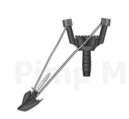

Hey guys I made a slingshot today, I call it the Tactical Bayonet Slingshot:
- tacsling.png (28.41 KiB) Viewed 4050 times
