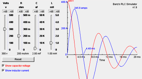

Have you modeled your cap+coil setups? With multiple stages the problem is that you can't get the later cap+coil pairs to discharge fast enough.
Timing is actually the least of the problems with multistages since there are a lot of ways to do the timing. There are not a lot of ways to make an RCL work faster and have sufficient magnetic field strength.
Every seen the really handly "Barry's RLC simutator"? (http://www.coilgun.info/mark2/rlcsim.htm)

- Barry's way cool RLC Simultor
- barrys_rlc.gif (22.36 KiB) Viewed 3521 times
