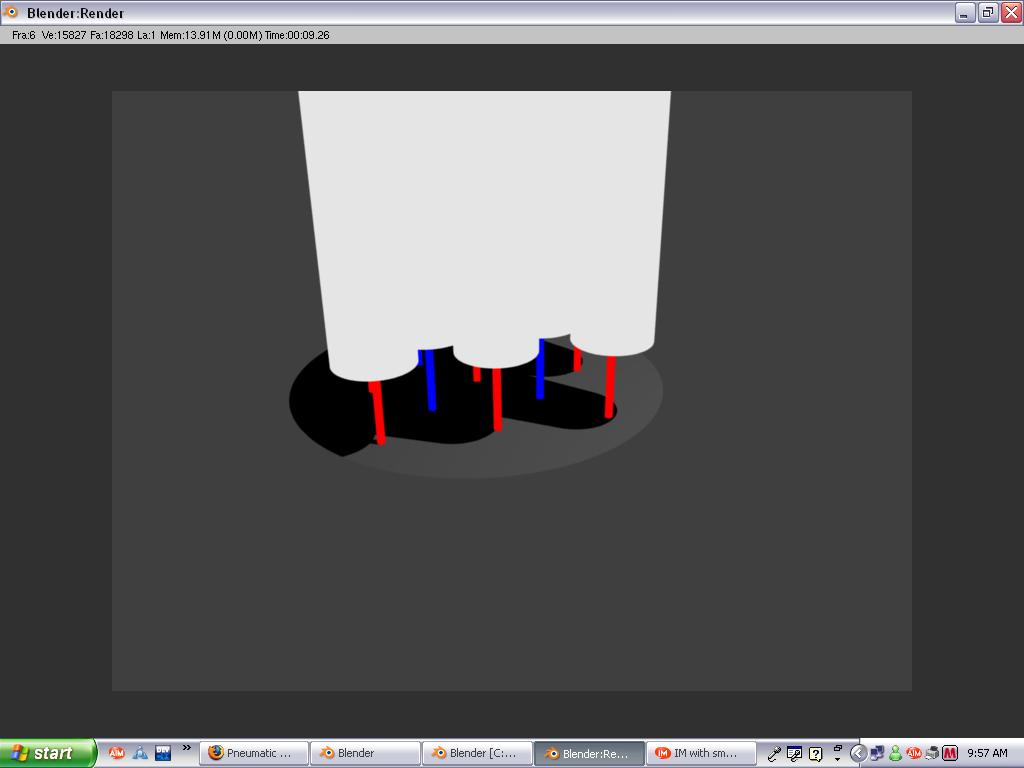

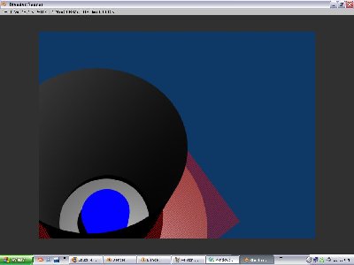

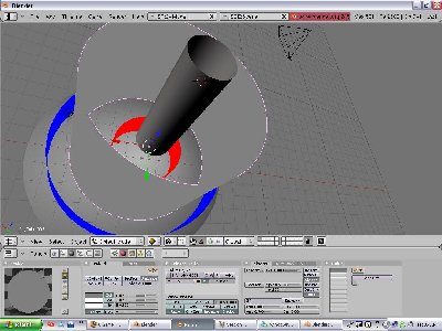

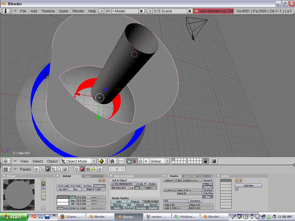

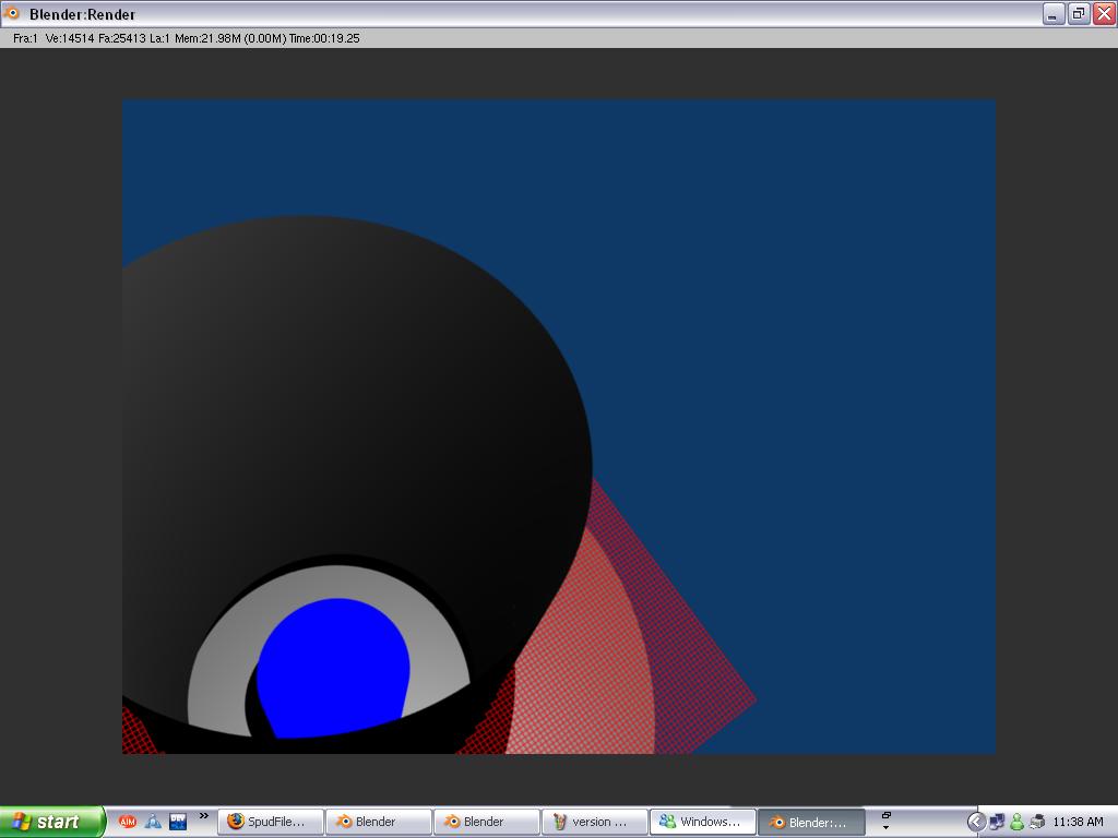

ok, lately ive been thinking of making an electrolysis machine, and ive been trying to think of ways to make it faster or more efficient. I would like input on which ones will work, and for the ones that work, which one would be the most efficient.
in the pics the things are kinda color coded:
the blue and red are the opposite electrodes
and white or grey is pipe
and dont yell at me for bad pics as i only had bout 20 min to make all three
and imagine that this all is inside a container
this one uses a solid electrode and a mesh or screen electrode
this one uses two sheets rolled into a tube for the electrodes
this one uses many rods the alternate polarity

The design of an efficient electrolysis cell is really pretty straight forward.
Rule number one: The electrodes should be plates and not wires. The larger the surface area the faster the cell will produce hydrogen and oxygen. Usually, the electrodes are simply flat plates.
Rule number two: The plates should be as close together as possible but not so close that the bubbles stick between the plates.
For example, see "mr. splitter"
