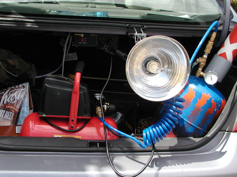

I have one of the $40 drill presses (crap but functional) and a small compressor that will work on my car inverter. Meets spec, but undersize which is OK as it will run on my undersize power source.
