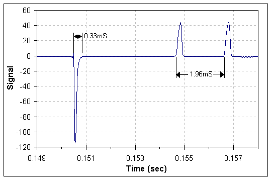

Why build your own? Because to some $70 is a lot, especially for a hobby and when for less than $10 you can build something that is more accurate than a $70 chrony.
How is it more accurate? Because it's operation is observable and understandable. A shooting chrony is a black box. How it is supposed to work and how it actually works is not necessarily the same thing. You can't tell if the Chrony did what it is supposed to do or if there was some problem. You really can't calibrate an F1 type chrony unless you have some very expensive equipment, or a $10 homemade chronometer.
ROF is nice. A $70 chrony won't do that.
Not putting a $70 (or much more) piece of equipment nearly in the line of fire is nice. Especially when the gun is homemade and the ammo is a veggie. Ya the round should miss the Chrony but ...
Getting a chrony to work with very small ammo (like an 0.177 bb) can be tricky.
Once the homemade chrony is setup you are 90% of the way to measuring other useful things like pressure and temperature transients in combustion guns, voltage versus time for things like coil guns ... all kinds of interesting stuff.
I'm surprised more coil gunners don't use homebrew chronies. It's pretty easy to get very useful information like velocity and V vs. T. How in the world can you fine tune a coil gun without that info?

- Voltage versus time (negative transient) and muzzle velocity data (positive transients) for a coil gun, using <$10 worth of parts.
- Typical_Recording.gif (6.83 KiB) Viewed 3226 times
